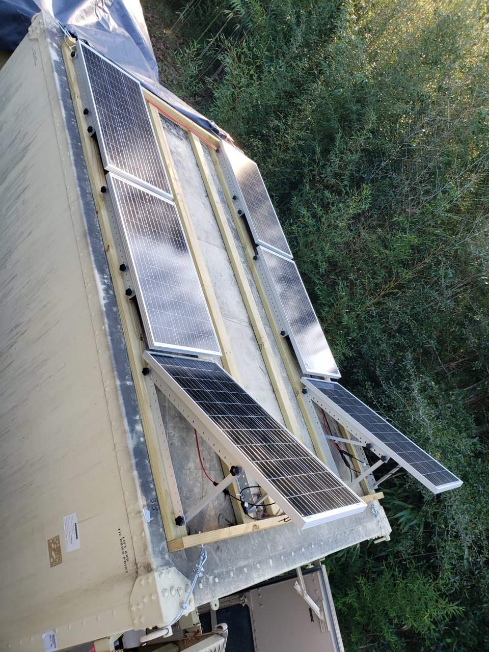

    20221012_101805.jpg I wouldn't want to go camping in my Tacoma as it is too small & has no cover over the bed. What I use is a bit different & have used it over the past few years here in Florida in the winter. The first picture is the battery bank.
