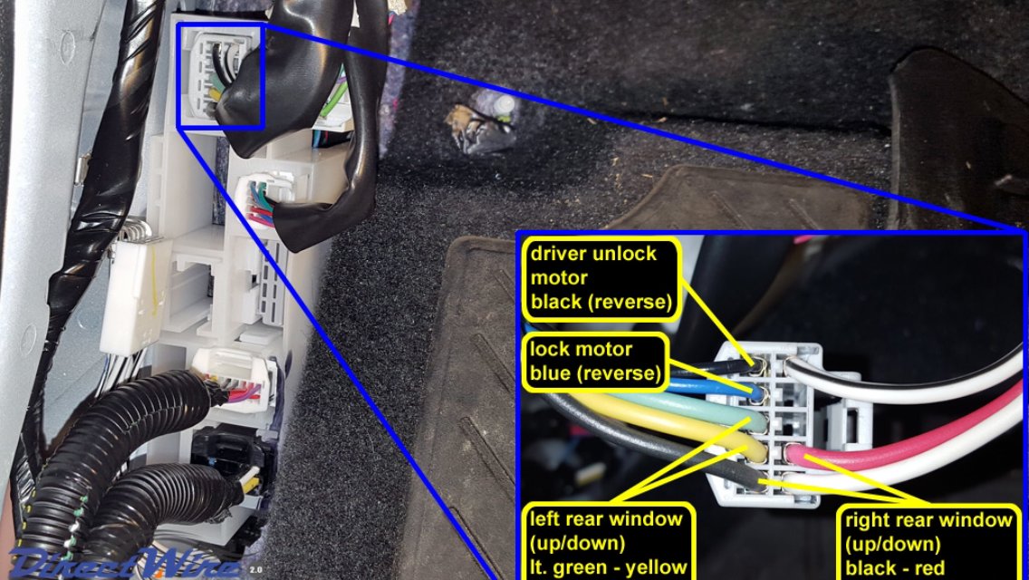

    Could be a few things. The locks on these trucks are weird. When hooking up an aftermarket alarm/remote start some modules have an issue with synchronization with the factory remote. So in order to bypass that you have to tap into the lock and unlock circuit. So they hardwire the locks to the negative lock and unlock wires. You could check for that and they would grab them at the dash fuse box or the drivers kick (pic #1 below) if they didn’t hardwire the locks, than they should run completely through the CAN bus and would be data controlled. But this doesn’t mean you would have a synchronization Issue. If you have a separate fob for the remote start (guessing not if you’re starting it through your factory fob, lock x3) then try to see if lock and unlock are working on that remote, if equipt.
    It could also be the cap, if it’s tied into the locks to control a locking actuator like you’re staying. They probably tapped into the lock/unlock motor wires in the kick panel. Does your locks work with the door switch? If not I would disconnect their wiring. Check the spot below (pic). Or perhaps they got them further back at one of the rear sills
    If taking it anywhere, I would take it back to the place that installed the cap or remote start first. Have them check over everything or remove their wiring. Toyota is just gonna give you a bill. Better to have them away especially if they are at fault. Hopefully if it’s due to their install they will cover any repairs Toyota will need to make.
