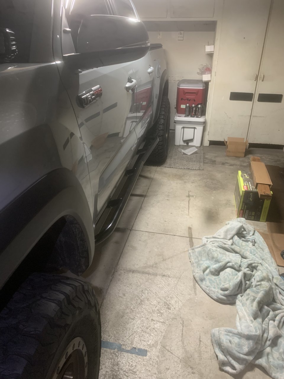

  18. Jan 25, 2021 at 8:41 PM
    #18
    Yota_TRD4x4
    Yota_TRD4x4 [OP] IG| Nimbus_pro
    Dec 6, 2020
    #348835
    72
    Tacoma TRD Pro
    Update: Installed one side of the RCI Rock Slider. It’s was bitch to screw a couple of the bolts but at least it’s complete with the exception of one bolt. I said f#%k it, can’t get it in. The black spray looks good on the rig though
