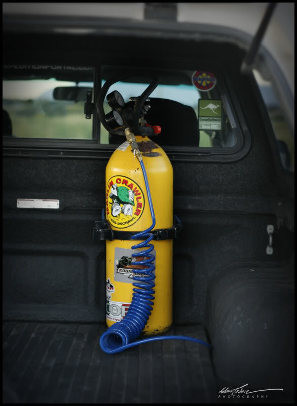

    I did something similar. I managed to find a 20lb food grade Co2 tank on craigslist from a local deli. Paid $20 for it and its been great! Love how fast Co2 fills!

    what bracket is that off ??? i need to find a cheap bracket for mine

    Its actually just a couple of pieces of angle iron that I made a frame out of and attached some quickfist clamps to. It works pretty good!

    This is a MUCH better solution. Same thing I've got on mine. That little 20 oz wouldn't fill a full set of tires after a trail run.
