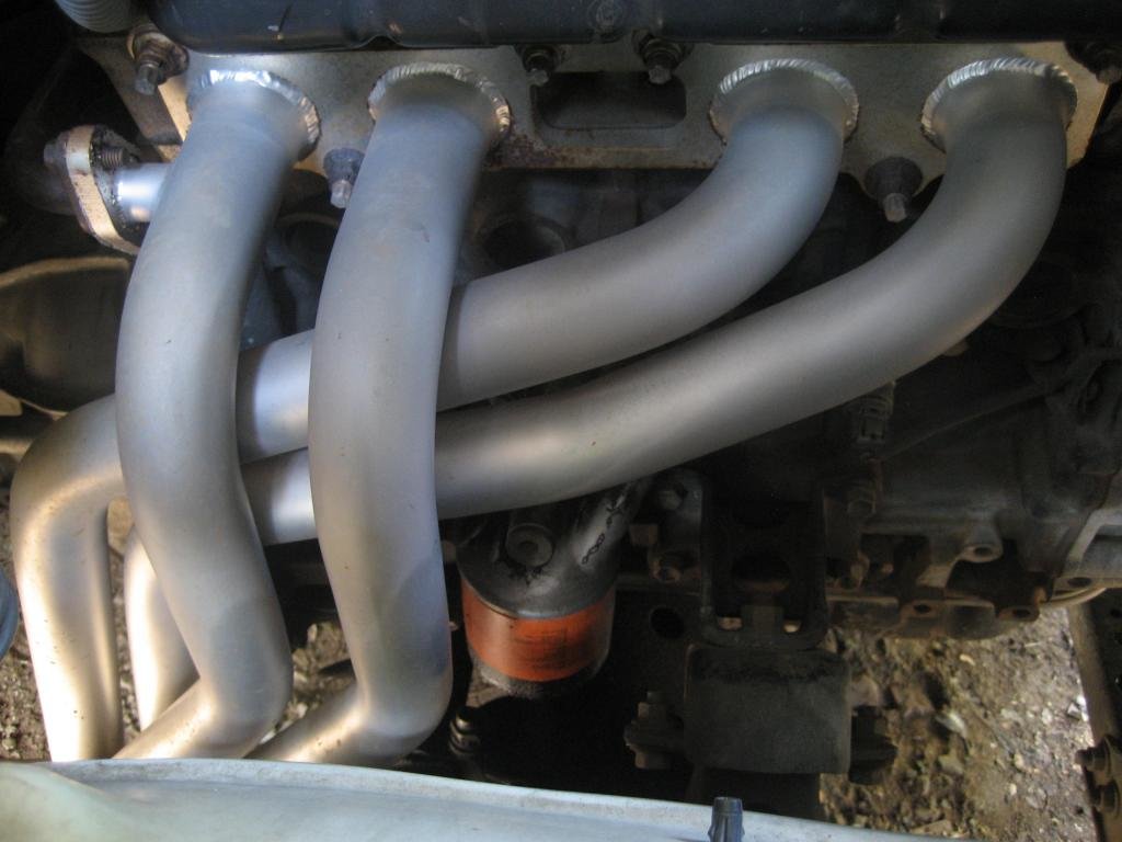

    The one that hands down gets the most results is the LCE long tube header ($475 shipped).
    63eecebd-d227-4758-af55-202fc9a4543c_zps_c76abb5afe56ac871da739345075a31da92c58db.jpg
    I ran mine on a dyno and it lowered the torque peak by 650 rpms.

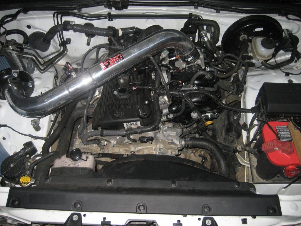

    I also run a really long Injen intake. And while I don't believe that it made any performance difference... it sounds freaking AWESOME! :)Nothing else sounds like it. This video is with the really quiet stock exhaust so all the sound you are hearing is only coming from the intake.

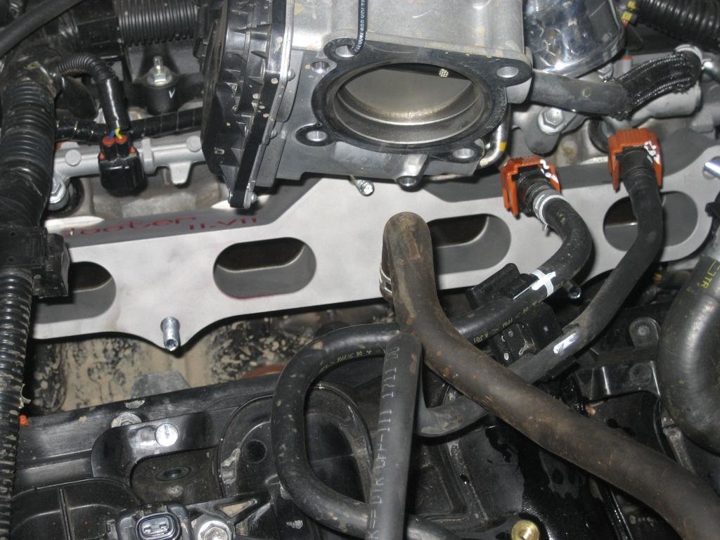

    I also run an intake manifold spacer ($245) that lowered the torque peak another 250 rpms...
    So for $940, I took a stock 2TR FE engine with a torque peak of 3,800 rpm, and turned it into a "tractor" engine that has a torque peak of just 2,900 rpm. :)

    I had a four cylinder '96 2.4 that I used as a work truck for 17 years. I also ran an LCE header and the engine ran really good with lots of low end pull. This is what it looked like after ten years. If you keep oil off of it, the ceramic coating will last indefinitely. :thumbsup:
