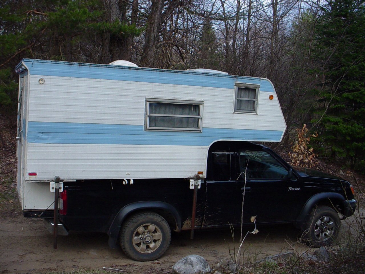

    603EA57E-C8E7-428B-B58A-0BF3EA9E1225.jpg I ran this camper on my frontier with timbren, zero issues. an on my 91 Toyota truck with out any suspension upgrade. Zero issues. Weight with full water propane and 75 Lb of food is 925. I still have this camper in NY. I’ve been debating on trying to fit it to my 17. I did find a place to make my front tire down mounts
    Borealis likes this.
