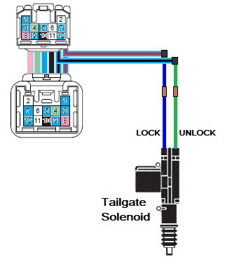

    The actuator needs power from the door lock/unlock in order to function properly. DC flow changes direction from lock to unlock. Are you adding a tailgate lock/unlock switch?

    you need to tap into 2 wires behind drivers side kick panel and run wires to tail gate.
    i forget which wires right now

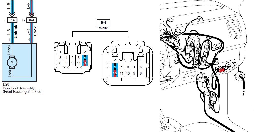

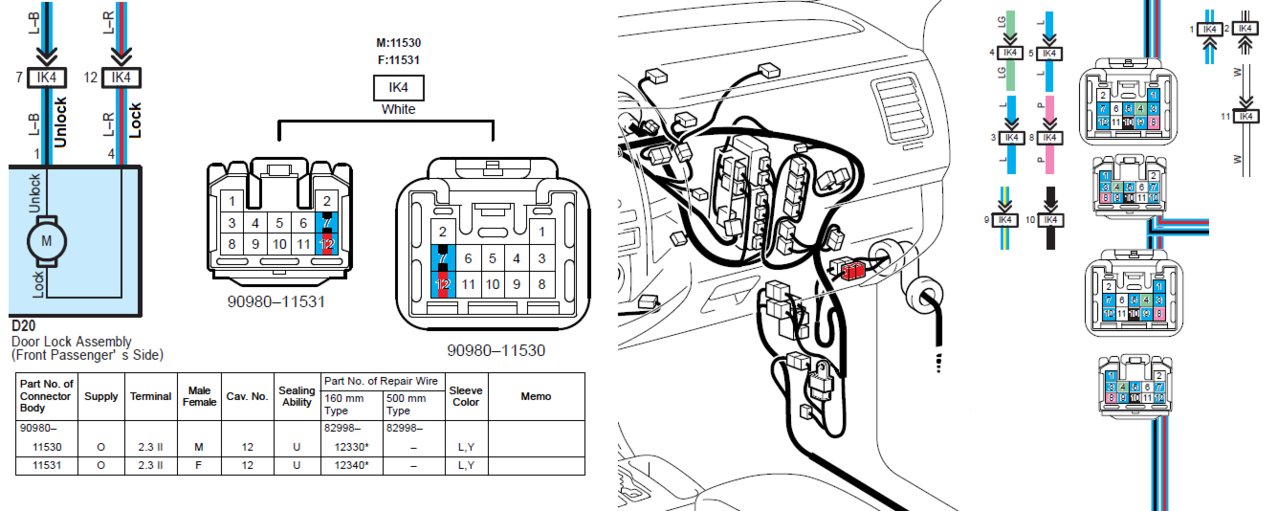

    Passenger side for unlock on 2nd FOB press

    Ok, thanks. And cool, any non-driver door makes sense for 2nd button fob.

    You could ask @KTJO 4x4 to make you a T harness so you don't cut the OEM wires.
