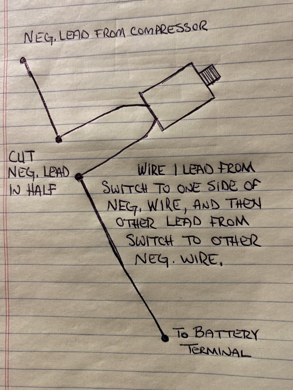

  9. Jan 24, 2021 at 7:15 PM
    #49
    toycoma 2016
    toycoma 2016 Well-Known Member
    Feb 28, 2016
    #179694
    539
    jason
    Williamsport, TN
    2021 cement OR 4x4 dcsb
    Lots
    Is this what you mean per your description?? Thanks
    tamer[QUOTED][OP] and MJTH like this.
  10. Jan 25, 2021 at 10:27 AM
    #50
    tamer
    tamer [OP] hamerworx.com
    Aug 21, 2008
    #8674
    847
    NorCal
    2015 TRD OR AC, MGM, 4x4, 6spd MT
    Yes! That's exactly it!
