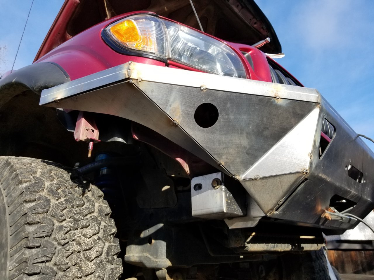

    if you want plate but worry about weight, you can go aluminum plate bumper. That's what I did
    Can't answer your question about the rear tire swing bumper, but if you want to go aluminum, they do exist (aluminum tire swing bumpers are available for jeeps, so I don't see why you couldn't get one for a tacoma)
