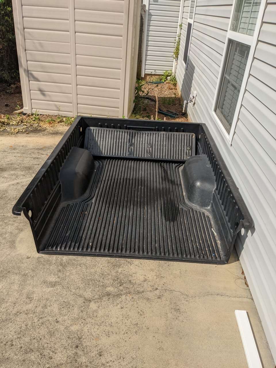

    What is better long term you guys think? I've got the original plastic liner for my Tacoma, wondering if I should put it back in or toss it and get spray in instead. (Took out liner because truck got a paint job)
    Price wise putting the original back in is free lol, I could also diy spray liner and then paying someone to do it is a bit pricer

    I ended up try cleaning up the plastic liner I had and putting it back in
