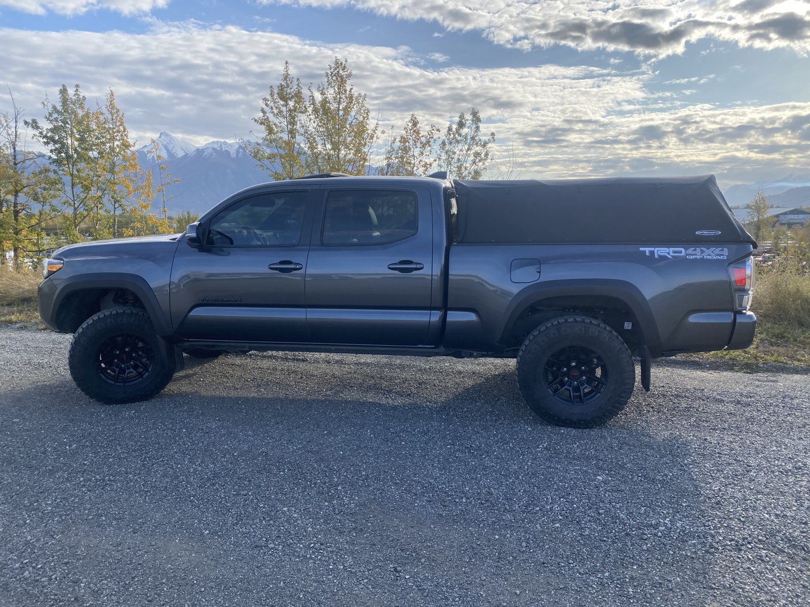

    DCBLB OR MGM 22
    Yes Toyota will lift DCBLB.. mine did
