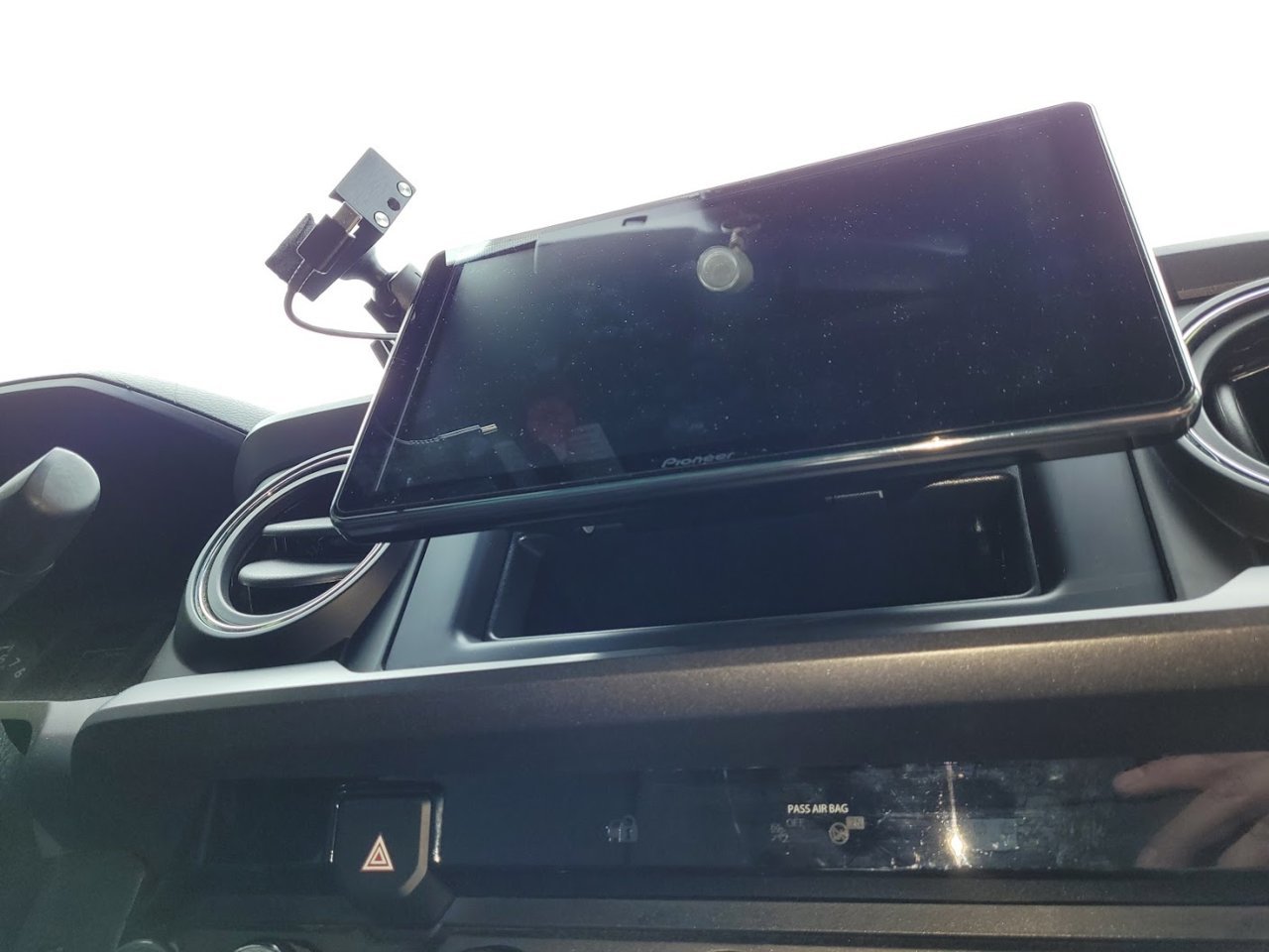

    I am just about to pull the trigger on either the 7600 or the 8600 on my 2017. I am worried that the 8600 would be too big, but looks Ok in the images posted here. Anyone have any comments on the size? Any sort of interference with vents or anything else with the 8600?
    Also, when fully installed, is the tilt on screen still adjustable? So that you can 1. Adjust for sunshine and glare, and 2. For accessing the cubby underneath?

    Neither offer an "on the fly" vertical slide/height adjustment. the height is set when installing. apparently both offer a tilt feature, but for me feels really stiff so ive never bothered to force it enough. the brightness on both screens is amazing and I've never had to worry about glare.

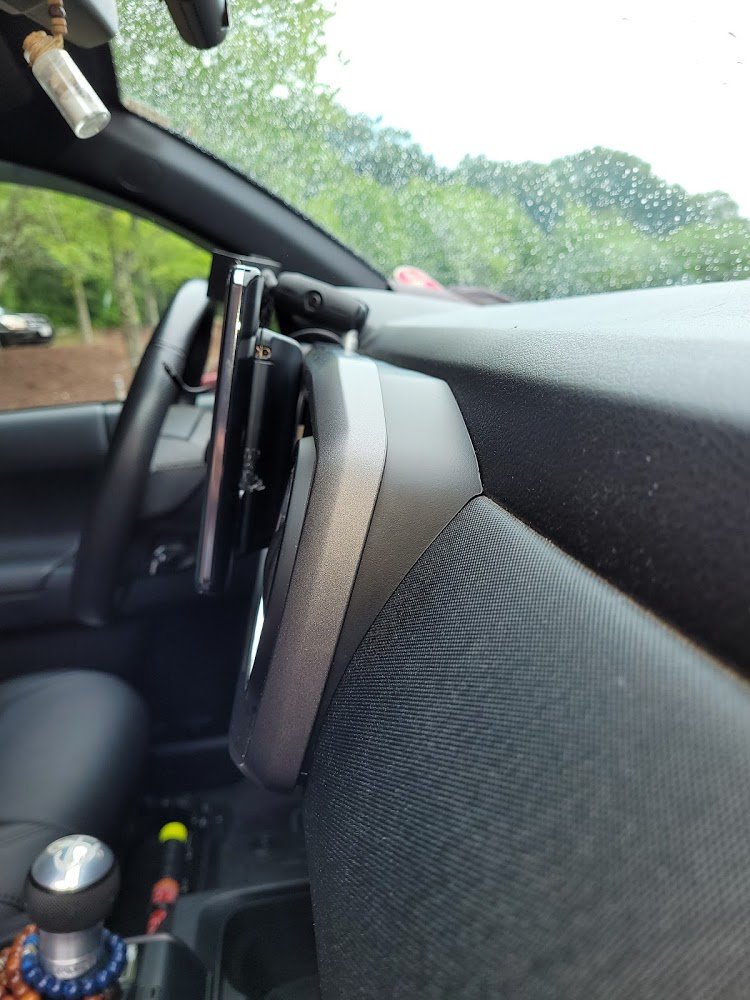

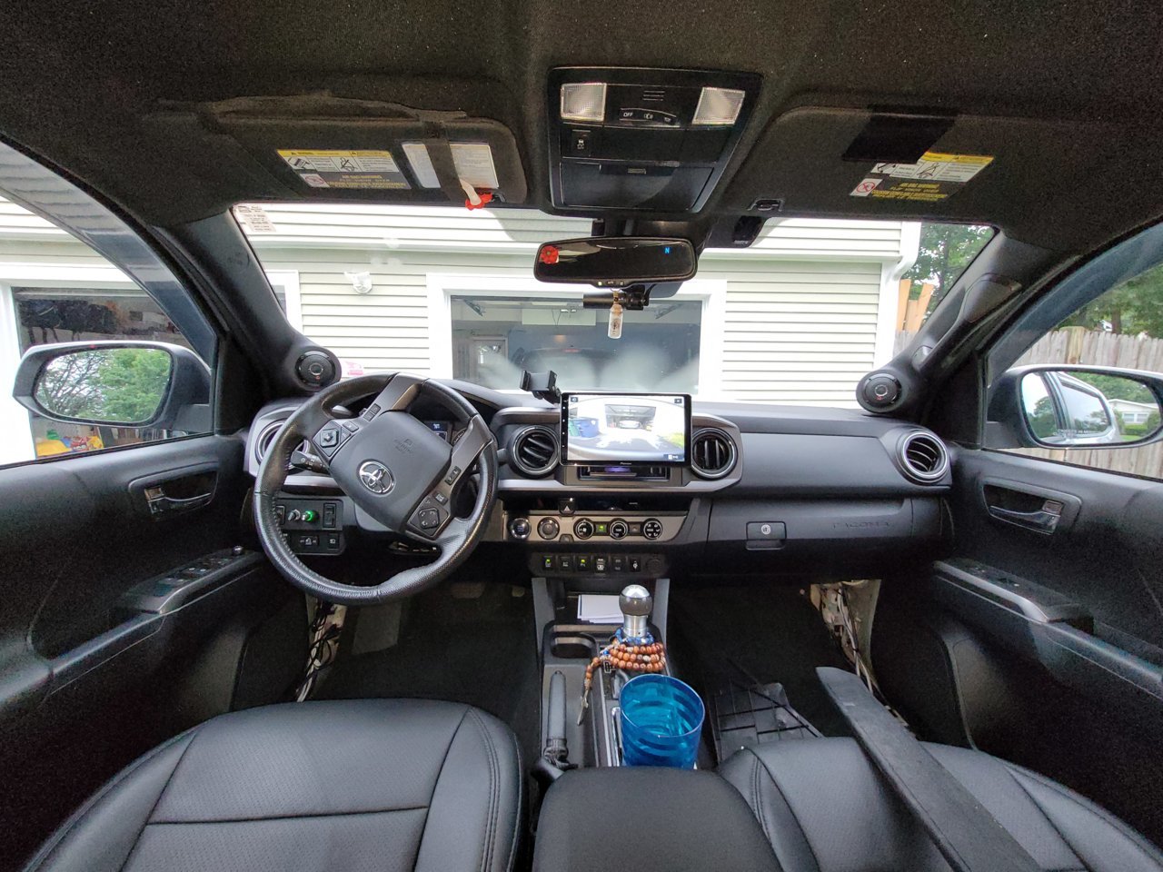

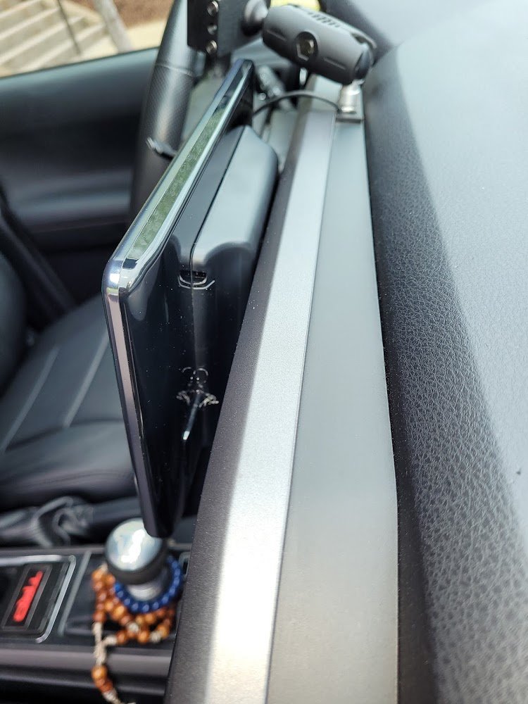

    Weekend observations:
    The screen is killer. I like the tablet look. I haven't had any glare issues with the sun, etc. The preset equalizer selections are pretty good and easy to manipulate.
    Because I am using a DSP integrated amp (JL VX1000/5i with TuN), I have all of the lowpass/highpass settings shut off. There was no clipping all the way up to volume setting 40 (pre amplification) so I set all the gains at a volume setting of 35. I left the volume on the head unit at 35, because I control the master volume via the JL DRC-205 (has 2 controllers - 1 for sub, 1 for volume).
    Right now my DSP is still set for the Kenwood. I'm waiting on my speaker pods to be completed (and maybe a different set of 6x9s) so I can retune everything at once. But for right now, totally not disappointed.
    Some more pictures:
    Pro-tip: when installing the screen to the base unit, I used a little dab of hot glue on the screw to keep it attached to the screwdriver. Those little bastards fall everywhere.....
