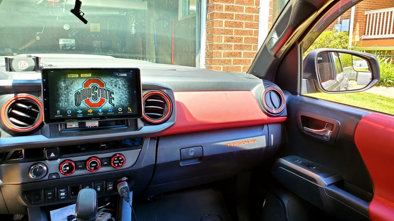

    I did a search and couldn’t find anything on this head unit, so here it is! Love the flush-mount setup with the smaller 9”, but I guess bigger is better?! Plus, the “floating” units kind of grew on me (came from a Halo9) so I wanted to try out Pioneer’s flagship.
    Loving it so far! (Apologies in advance for the track selection in the photo – damn Spotify radio)

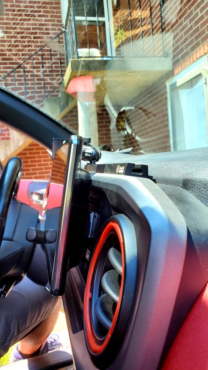

    do you have a pic from the side? to how it sticks out?

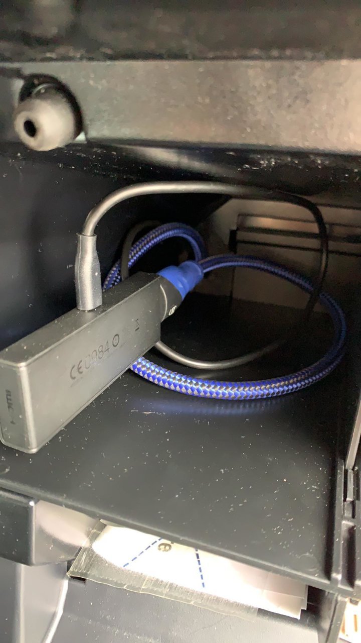

    Nice! Yeah, the one USB port is kind of a bummer, but you can easily wire up a USB hub/switcher and put it in your glove box or center console?

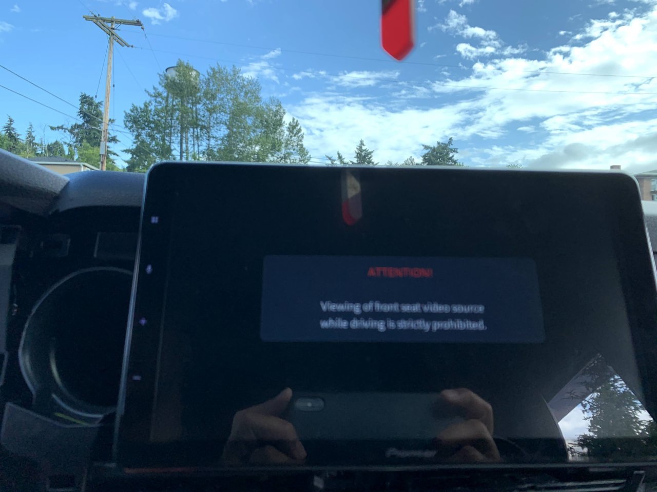

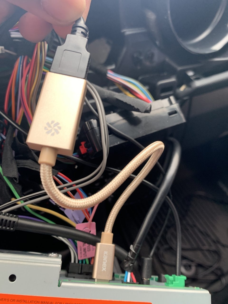

    Is anyone running HDMI input? I wired an Amazon FireTV stick into my glovebox to the micro-HDMI to the back of the head unit. I also have the e-brake bypass. I'm still getting the error message when the truck is in motion, and can't for the life of me figure out what needs to be bypassed. My speed sensor wire is disconnected, and I also tried it with the GPS disconnected. No dice.
    Sorry for the crappy photos!

    Thanks for the replies! Finally figured out the bypass last week, and all is well in the world!
    This should work for all the latest Pioneer DMH models, no longer requiring the hardwired relay/pulse e-brake or GPS bypass.
