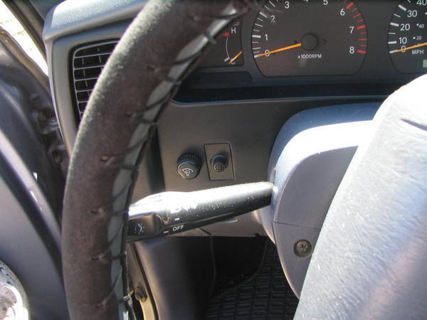

    Here's a pic of my mic mount. Finally had time to finish that today.

    Very Nice!! :D
