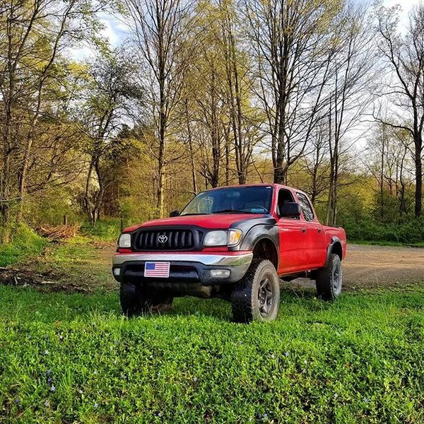

    I'm going to do a steel flatbed on my 2001 double cab (with of course the 5 foot bed) can I getsome ideas?18299359_417752398587316_185318583167877120_n.jpg

    Whyyyyyyy that's a lot of added weight do youbhave add a leafs or timbrens to handle it? Do you plan on regearing or putting a heavier flywheel in if you need to? If you're making it a true steel flat bed that's like 500+ pounds why not go aluminum?

    If he went steel he's well over 500lbs for a flatbed thats strong enough to be worth it more likely 800lbs (family construction business even our lightest flat beds are about 1000)... His suspension looks level already even if it were only +300 lbs empty if he loads anything heavy enough to justify his want for a flat bed yes he will need all that or his ride quality will suffer significantly. if it was just driving around a farm who cares but i wouldn't take it on the highway like that without atleast a suspension overhaul.
