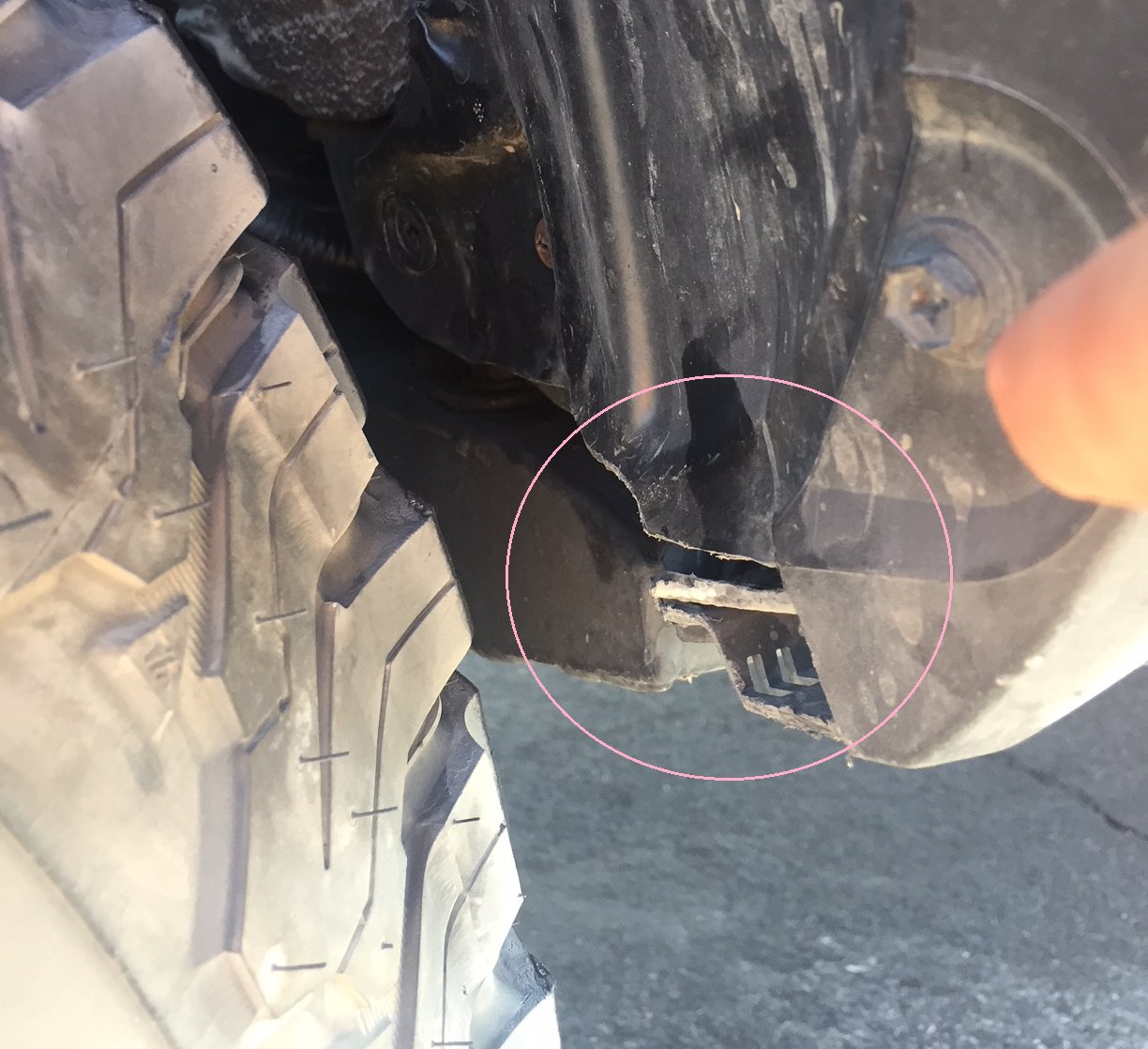

    I got a CMC but still rubbing on the rear fender area (circled in this photo) when flexed. Does anyone have pics of how you trimmed this part? There is a bolt right behind the area that is rubbing, so I am hesitant to cut that off. I only have 275/17's! Kings with 3" lift and total chaos UCA's this should not be happening. Caster is at 2.0 if that makes a difference.

    Not only trimmed plastic but the pinch weld behind it.

    Oh wow you really cut that out. I already did the pinch weld, so this is what I need to do now. Appreciate it!

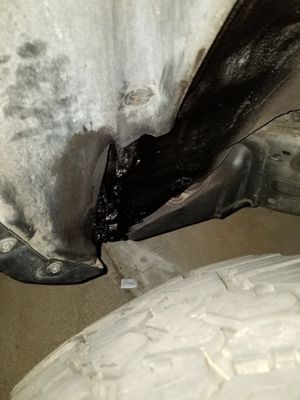

    Trimmed/undercoated like a boss. The furthest part that sticks out is the rubber butt plug

    that looks really clean. what did you use for undercoat? did you remove all the plastic?

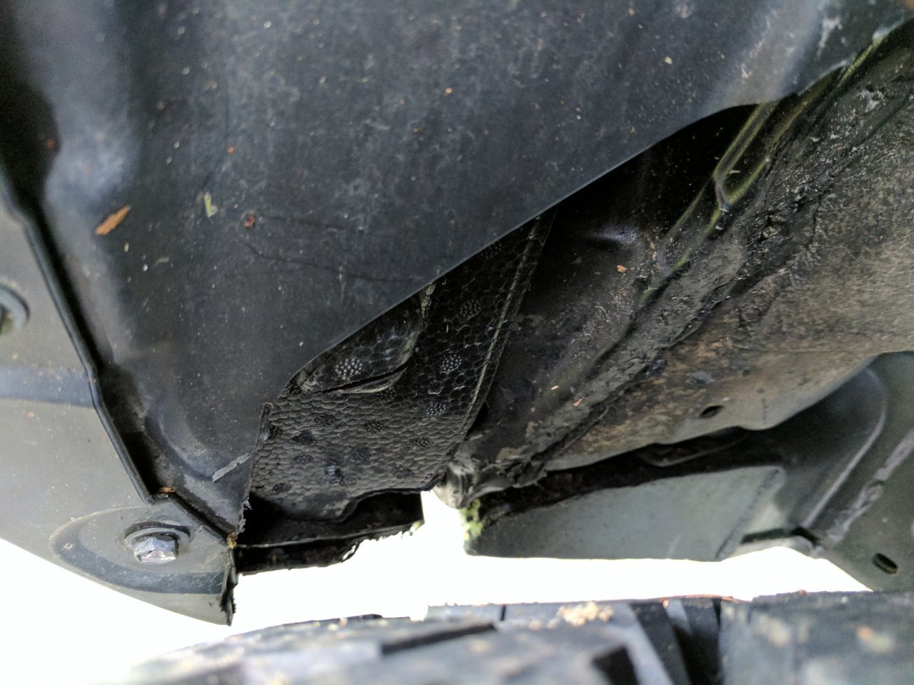

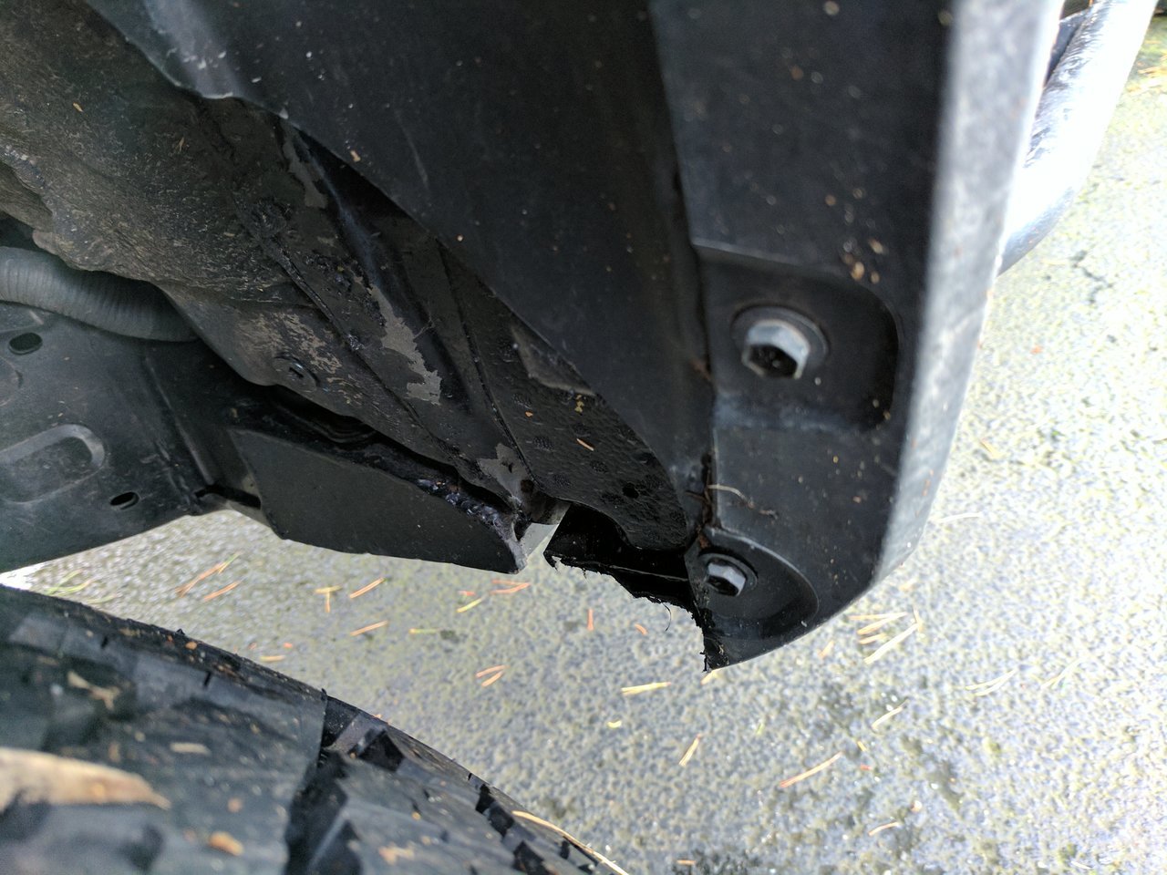

    2017-12-07 17.13.12.jpg I'm learning that the BS and offset makes a HUGE difference. I have F5's 17x8.5 4.3bs/-10mm os. Had to really trim alot. Also beat my pinchweld out instead of in, probably too late to reverse now.trim.
    The plastic flare needs to be cut as well, currently looking for what works best. Also think im rubbing just a tiny bit up front. Caster is 3.8/4.1. If I would have went with a wheel with say 4.5bs/0 offset would have been better.

    Get it pushed out to at least 3, if possible 4. I rubbed A LOT when I was at 2.5, now with with at 3.9, it only rubs in reverse (running 285/70/17)

    even at 4, my wheel at only that particular angle would rub on the corner, which means when compressed probably worse. So gonna chop off the plastic in the corner as well, dremel time.
