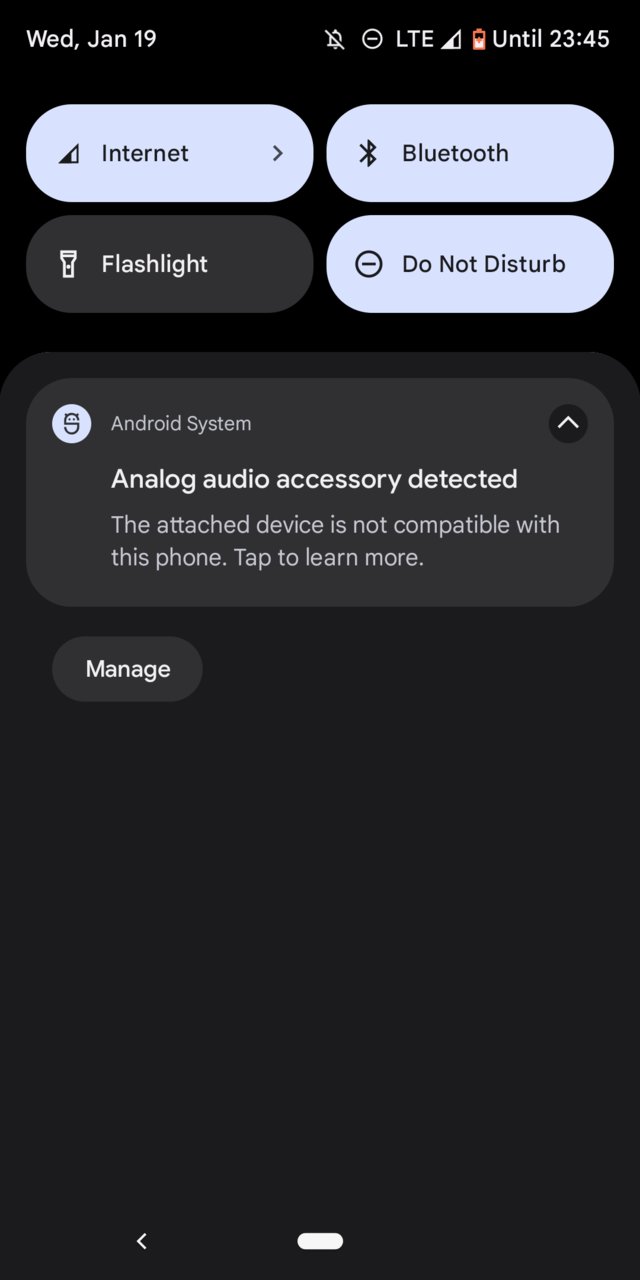

    Plugged in my phone to the Tacoma today and it doesn't register as connected. Connects via Bluetooth but not with the USB. It's charging when plugged in, just not registering. Here's what I've noticed
    No connection to Android Auto causing....
    Android auto to not show up as an input option on the radio
    Cannot access maps through the phone on the head unit.
    I get the notification below that I'm connecting to a no compatible analog device. Phone is a Google pixel 3. Worked just fine yesterday. Hope this all makes sense
    Any ideas?
    Edit: I bought a new USB cable this morning, when it happened, thinking that it was the cable. problem remained.
