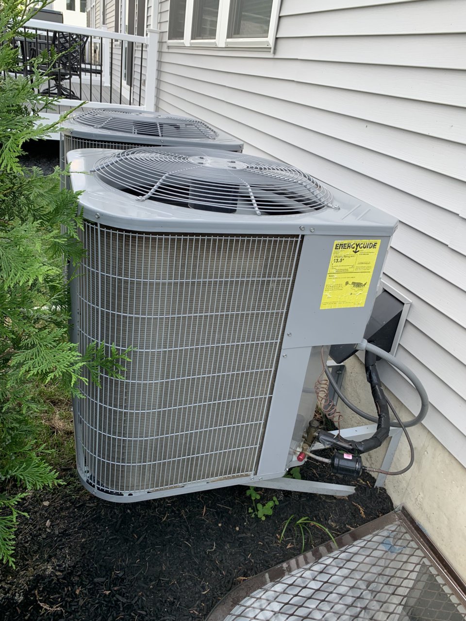

    4-ton Carrier at the Gwynedd, which despite being a full nominal-ton smaller than the 5-ton at the Casey, is physically larger...

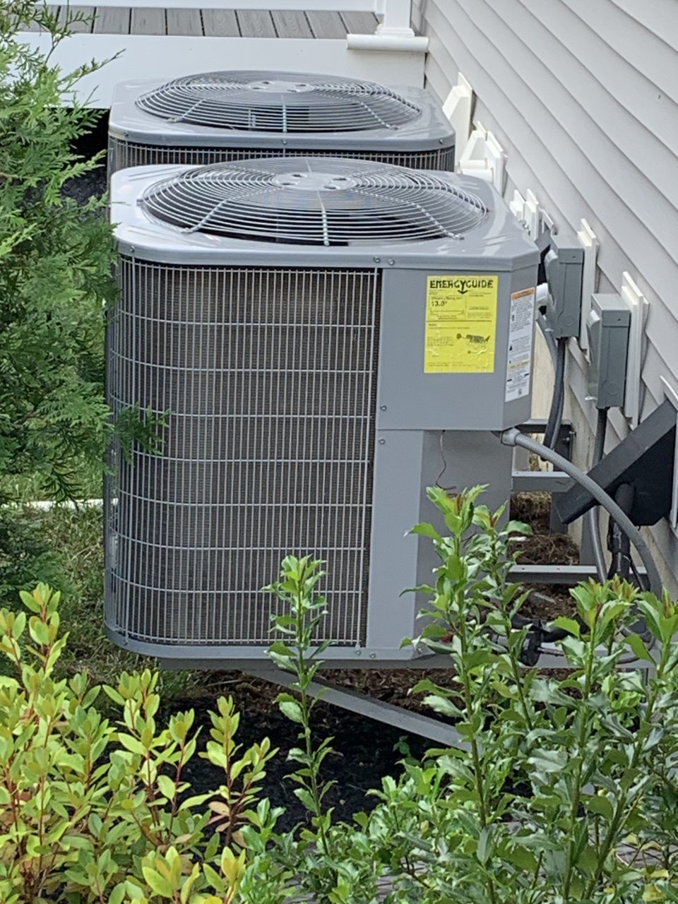

    The two decorated models in Doylestown Walk both have 4-ton Carrier "Sentry" 13 SEER units, and all of the models in Regency at Waterside have Carrier Sentry units as well...

    4-ton Carrier Sentry at the Derby model...

    The air-conditioner directly behind it belongs to the house next door...
