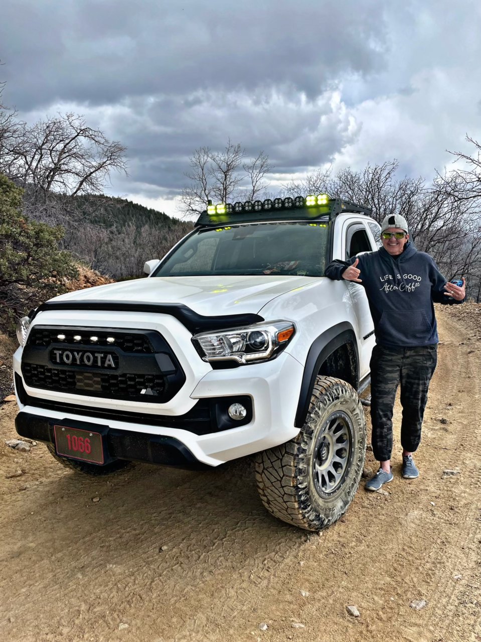

    So, my 2019 Tacoma off road access cab had spacers and bigger tires. I lost 3 mpg with this! Oh but it looks good. I just added the pedal commander. Eco mode best mpg is 14.5! Freeway driving. Went up to Prescott, not pulling anything. 14.5/ mpg went to City mode, still says 14.5?? Does this sound right?? Seems really low?? Is this correct? Thx

    Sounds about right. Don't expect any better fuel economy with a pedal commander. All those devices do is adjust throttle pedal sensitivity. Your oversized tires and driving habits are what need to be changed to see an improvement in MPG's.

    Anything that increases rolling resistance -- taller, wider, heavier tires or increases profile against the wind -- lift, roof rack, air dam delete -- will decrease mileage. Higher speeds really hurt economy with these trucks too, it really drops when over 65 mph.
    Poor economy aside you have a great looking truck there. :thumbsup::thumbsup:

    How big of a tire? You also have, mud tires, roof rack and heavier side steps. Most likely you’re also loaded with some items in the bed. 14.5 sounds about right.

    Lots of other factors to consider like speed and wind. Everyone says highway and typically highway mileage is better by far on most vehicles, but those of us with vehicles that are far (yours is even worse with roof/light rack) from aerodynamic, MPGs take a drastic dip above a certain MPH. I noticed mine take a nose dive about 60-65.
    Overall, 14.5 sounds about right for your outfit. I have one up on tire size and a 2/1 level kit and I’m down to 17-18 all highway, but I keep it below 70 mph.

    What size and load range are your nittos?

    Yep. Physics say ditch the weight, put regular tires on it, lose the lift and *boom* a miracle occurs and you instantly gain 5 mpg.
    Looks cost.
