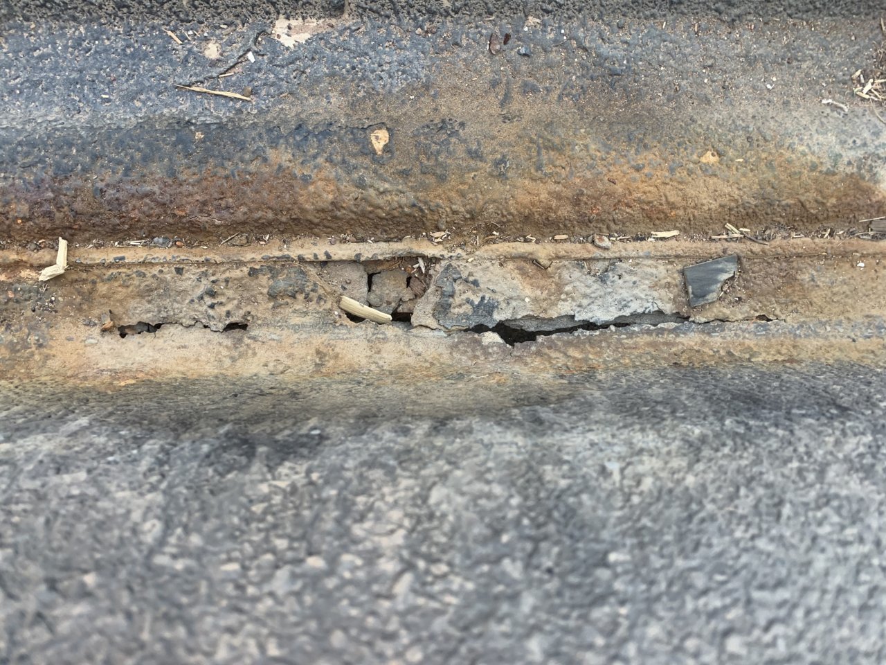

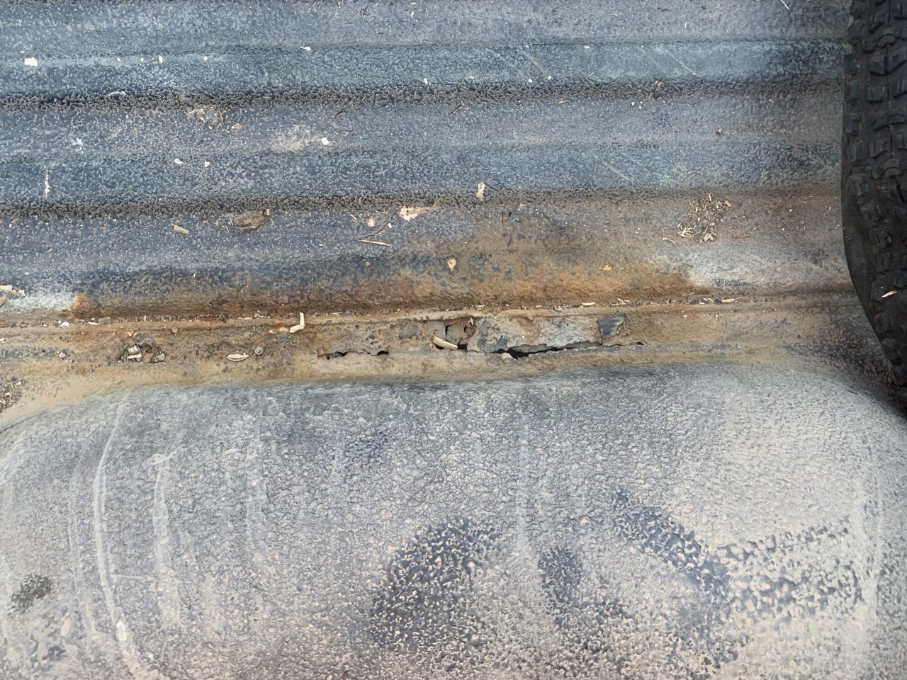

    Here’s a couple pics. Really isn’t too bad but I’d like to patch it. The front of the truck is to the right in the pics.

    Mine had the same exact thing. I ground out the old rusty metal and patched it with bondo. Got a kit at the parts store.
    Then painted with rustoleum rust primer and professional undercoat.
    Has held up great for almost 2 yrs. Does not look perfect but I do not care. It’s sealed.

    ah, they all do rust there, right on the seam
    What you have to do is cut off what is rusted through then weld a new patch in place, so stab around the rust hole with a screwdriver to find what is good and what is bad
    Once you have done this, wire brush throroughly to remove as much rust as possible, weld the patch, treat with a rust killer/converter and repaint
    here's a good tutorial video
    https://www.youtube.com/watch?v=C0M5tUQSaps
    By the way, is that spray-on bedliner on your bed? Good luck, this stuff is rock hard....

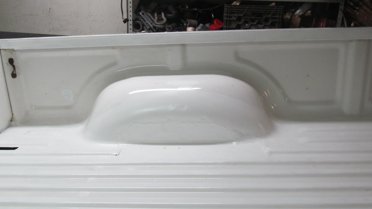

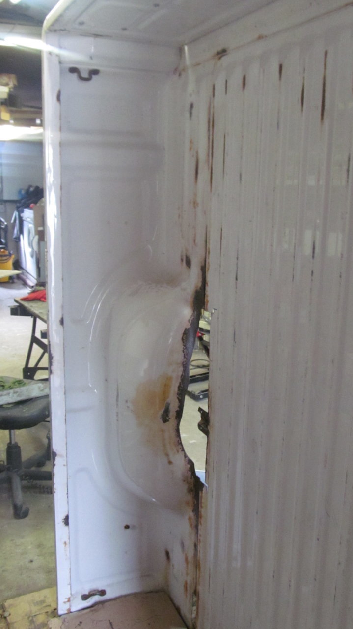

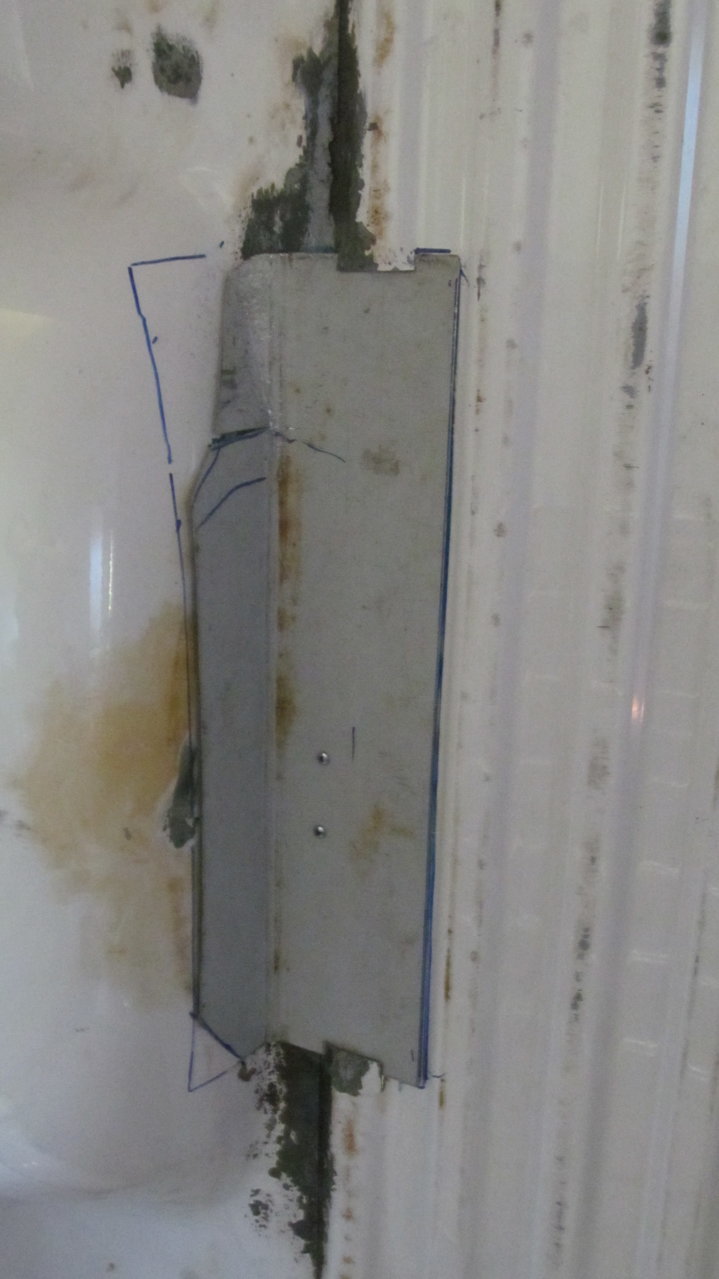

    Here is my repair:
    I used L-flashing angle, the type you use for roofs, to patch my bed. It's pretty much the same thickness as the wheel well section but it's also a tad thinner than the corrugated bed floor
    [​IMG] [​IMG] [​IMG]

    Thanks guys, figured it'd be a mostly easy fix. I might just go the bondo route for now until I can get it into my buddies shop to maybe weld a patch on, After doing some more digging around it seems that it is SUPER common for this to happen to our 1st gens, especially on the passenger side for some reason. I read somewhere a guy had a theory that since that spot is close to the muffler maybe heat and moisture combined affect something, who knows.
    To answer the question above, yup its a spray on liner so thanks for the wishes of good luck hahaha
