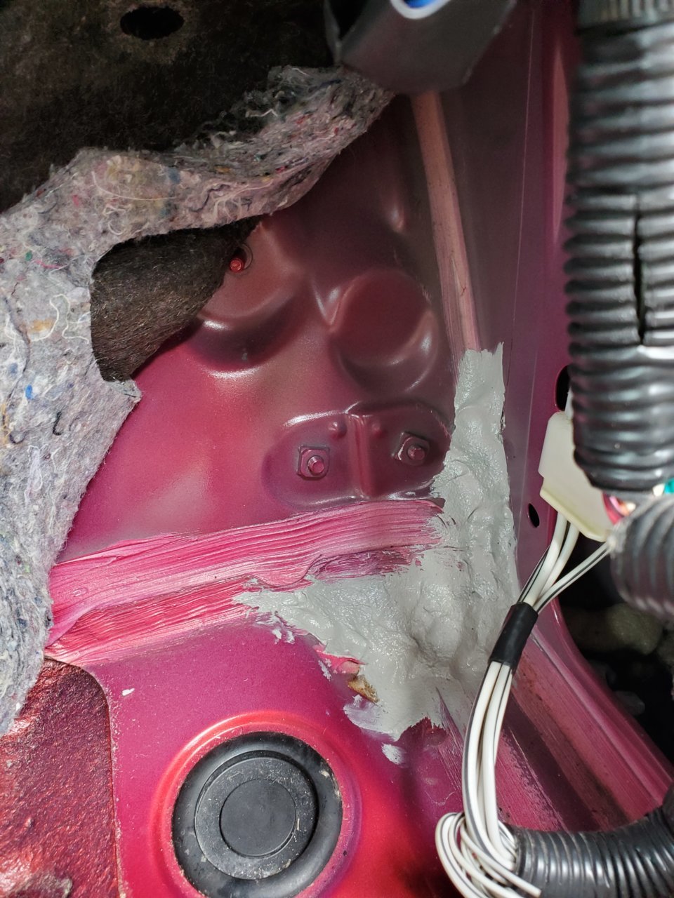

    I think I have read every post on second gen passenger leaks. My leak is not AC or vent related. My cabin filter is dry. The grommet in the side is positioned properly and not leaking.
    I pulled the glove box, kick plate, passenger seat, carpet etc. and sat in the truck when it rained. The leak is coming from the seam in the corner where the cab floor and firewall meet. The seem doesn't appear compromised. I cleaned it up with alcohol and resealed it on the inside.
    This might not be relevant, but a few months ago I saw a mouse duck behind the hood hinge on that side. So I am concerned there is a clogged drain or something that is not allowing the water to flow properly. Is this possible? Do I need to remove the fender?

    To follow up. We have had several heavy rain storms now and no more water leaks. Tremco - Vulkem 116 in gray appears to have solved my water leak. lol

    Hopefully, the body shop solves the issue expeditiously. If not remove the drivers seat, carpet and some plastic trim. This is actually pretty easy to do. Then lay in the truck with a light while a buddy sprays water on windshield, cowling, fender seams etc. With the amount of water in your truck you will find the leak. It wouldn't surprise me if the seam on the drivers side was compromised like the seam on my passenger side. As an add, mine hasn't leaked a drop since I resealed the seam. Good luck!
