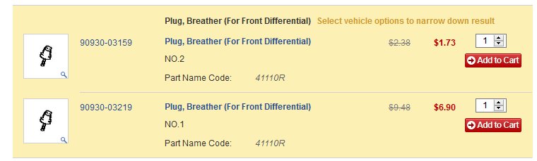

    Okay everyone, we all know about the rear differential relocation mod. BUT everyone seems to be using the one way vent (Not a breather, it is a one way vent). NOW I have searched high and low for the damn part number to the two way breather valve, it is used in the front differential as the breather and is barbed instead of being threaded like the vent. Tons of people refer to it, ask about it, say they have gotten in but no one adds in the part number. Does anyone know the part number for the barbed two way breather cap? Thanks taco brothers and sisters

    For the third gen. it could be one, or both of these. Both are listed for the front diff.:
    Toyota Part No.: 90930-03219
    Toyota Part No.: 90930-03159

    Thanks man! Appreciate it... now I have four part numbers to ask for at the stealership
    Will confirm which one is "best" next week
