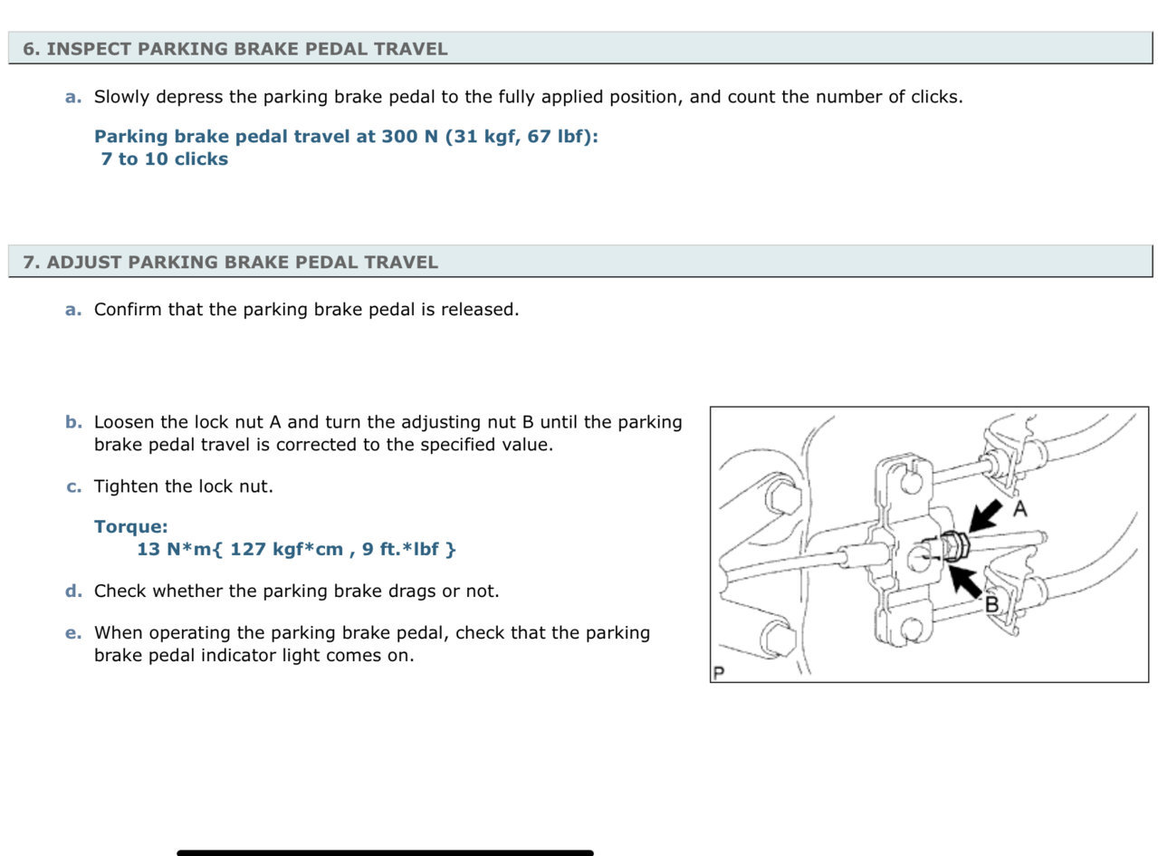

    I’m going to be fixing my bearing break, as I realized that my parking break won’t hold me on a 15% grade road on wet conditions.
    So correct me if I’m wrong.
    If the nut is further AFT/Rear I’m “releasing” tension, and if it is further Forward I’m “increasing” tension?
    If the nut is far forward as it can go, what else can I do or Adjust? (I got the vehicle set as seen on the photo)
    I don’t want to be parked on a grade relying on the parking Pawl.
    side note. Very squishy breaks in general, 50% foot depression feels like 20-30% breaking power.

    You also adjust at the rear drums.

    Correct on the adjustment. If you are out of usable thread I would say you should release tension and adjust at the drum star first.

    Drum first, adjust the cable under the console last.
    The cable under the console should have slack when not engaged.
    If you crank that nut too far you'll drag the drums and overheat them.

    I do have to be honest here.
    I’ve never adjusted my brakes per the manual.
    Adjust until they drag SLIGHTLY , press the brake pedal 2-3 times, recheck for a slight drag.

    I don’t like having the whole truck resting on the parking pawl alone, and I have trust issues feeling my truck roll back on a gentle slope with no cargo.
    I bought 2 wheel chocks.
    I found that that there is 3 points of adjustment you can fiddle with.
    1 - Rear dumb parking break star thing.
    2 - Under the centre console that long thread and screw.
    3 - Under the parking break itself. (Not often talked about) the cable attached to the foot mechanism, where it has a long thread and 2 nuts you can adjust the tension.
    I had to do 3 as I ran out of adjustment on 2.
