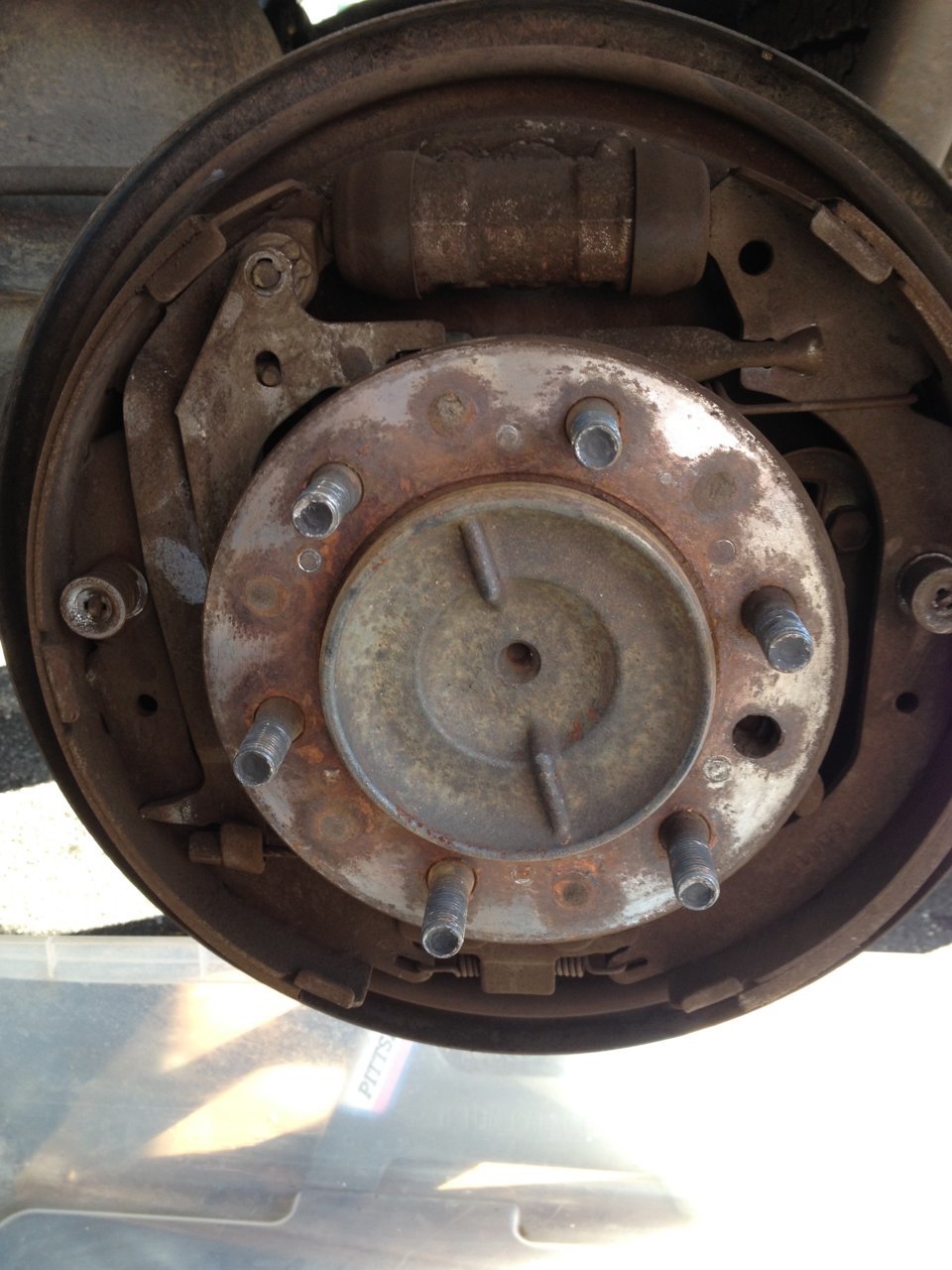

    Might be able to narrow it down to one side or the other by jacking up the rear, both sides together with the park brake engaged and see if both wheels feel the same on difficulty of rotating the tire by hand.

    upload_2019-4-5_13-56-32.jpg Howdy, this picture makes me think the belcrank is stuck. That's what is giving me a hard time.
