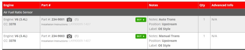

    According to Denso website it uses a 234-9001 for manual -9002 for auto

    Glad you made it safe. What is the Toyota part number?
