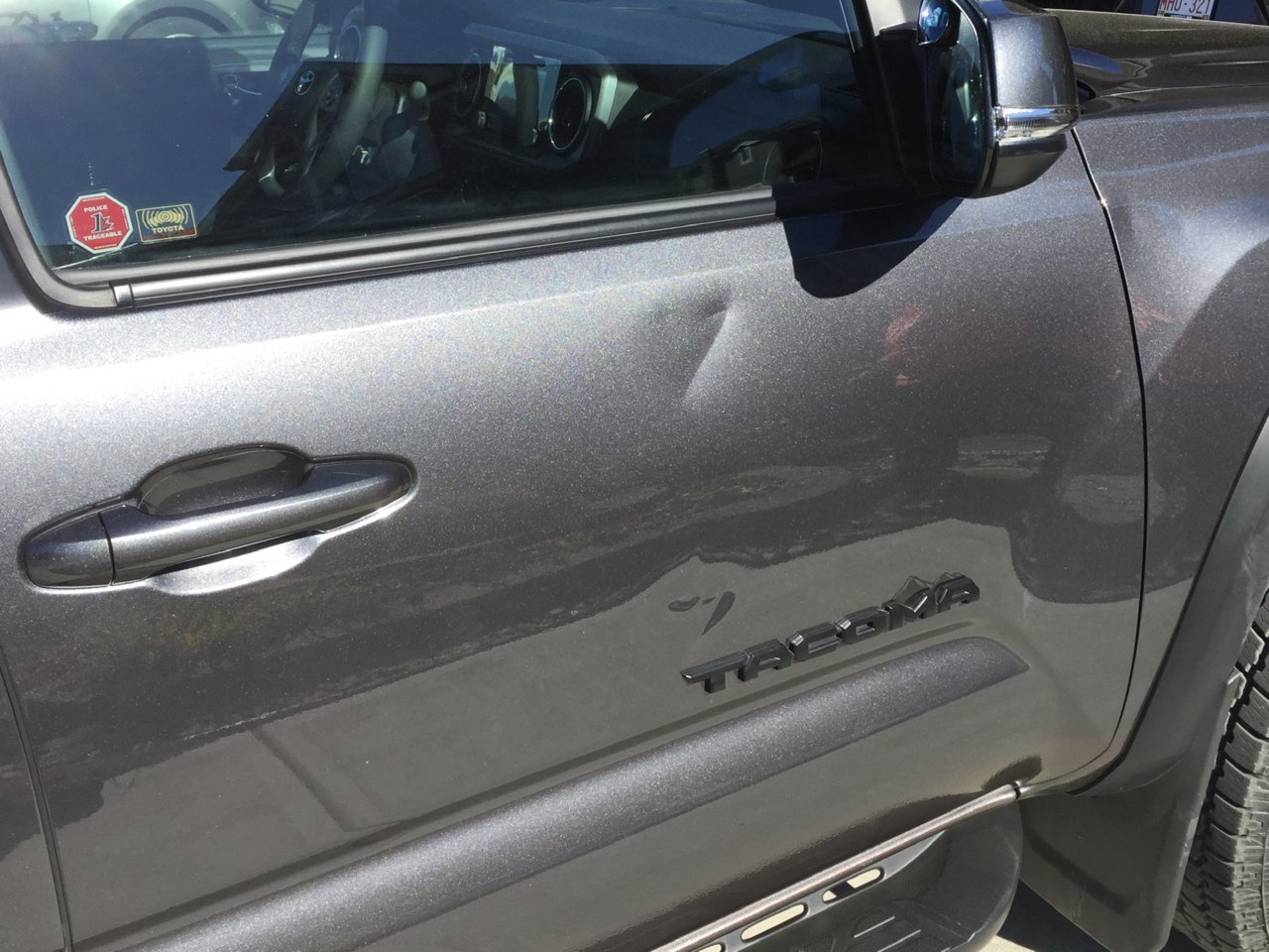

    Just saw a post on whether or not a guy should repair his truck after getting hit and run, I’m not sure why this is even a debate on a newer truck.
    For those of you who have not had or seen Paintless dent repair I have pictures of what a really good Paintless dent repair person can do.
    These dents (there are two if you look close one above the other )were extremely deep and sharp from the handle bar on my motorcycle backing out of the garage (I know I’m a dumbass)
    They are almost invisible now.
    They are only really visible in the sun because the paint got distorted.
    Before

    I have had excellent results with PDR....It definitely is based on the skill of the person doing it.My personal opinion is that yours is too damaged for this.

    I've had PDR on another vehicle with great results. The guy that did the work also showed me how the process worked so that was cool. As far as the OP stated it only slightly noticeable, could be like the guy mentioned who did the work for me that's it's near impossible to get it perfect because those dents slightly stretch the metal. Another thing, I'm of the belief that any auto body shop will never ever...ever be able to match a factory paint job.

    It was one of the tougher ones he had done
    I had one shop tell me to get it painted because it won’t come out using paintless repair
    The pictures don’t do justice on how deep these were.
    He had it for a day and a half, took the door right off the truck and he is super fussy, so what you and I would consider good he could not.
    He wasn’t happy until it would not ripple in the light.
    It was 800 CND which was worth it not to have it painted.
    He charges a lot less than that for normal hail and door dings.
