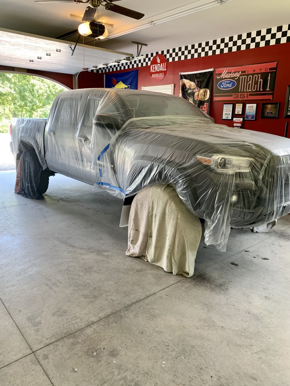

    Lookin’ sexy! Hopefully this will be good enough. Definitely a pain in the ass, but probably worth it. Once I’m done with this & have it looking a bit fresher underneath, I’m going to make an appoint to have it coated. Hopefully that will protect it & keep it looking good. This is what one local shop uses:

    A good wax or ceramic job prior to painting is a good idea. Luckily, my truck is ceramic coated. However, I don’t think any overspray found it’s way onto the paint. I had it wrapped pretty well in plastic and upon removing it, the body panels were still smooth and slippery.
    So, overall, I think it was a success. I’m glad I did it. It was a long day, but it looks great underneath and is ready for “winterization.”
