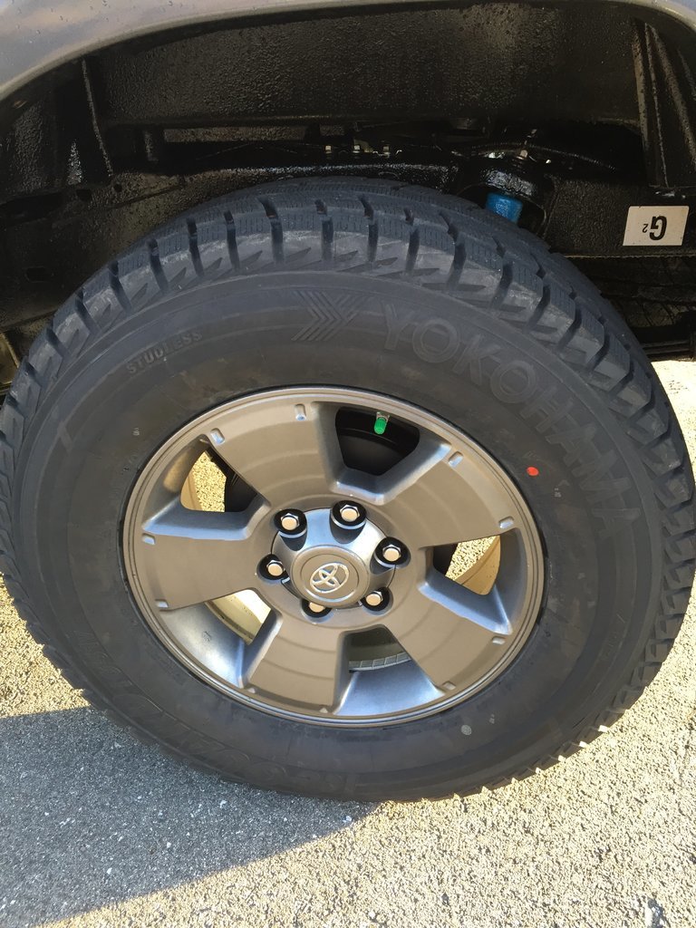

    It's not a bad idea if you want to change the look of your wheels. Just do a google search and you'll find lots of how to videos and such. The prep work is the hard part and the amount you have to do will depend on the condition of your wheels. I bought a set of corroded to shit sport wheels to use for my winter tires. Lots of sanding, primer and duplicolor graphite wheel paint and it's held up surprisingly well over 2 winters.

    @rjbiii That looks awesome. Color looks spot on! Are you going to paint the wheels with the tires on them? And yes, I would like to see the after product.

    Thanks! And yep, thats the plan. Im gonna use newspaper and painters tape and just take the wheels and tires off the truck and tape them up. Ill post up some pics when i finish up!
