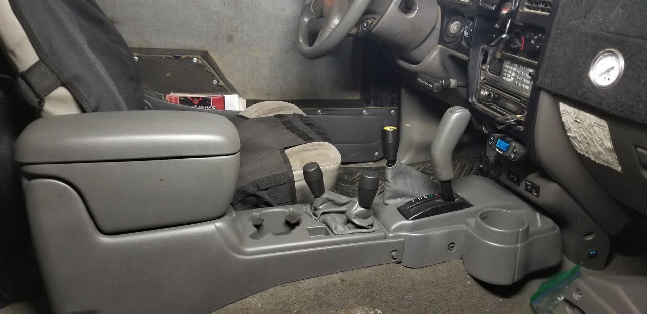

    https://www.colorbondpaint.com/
    Used this on my interior to color match my custom center console and color match leather boots.
    Would recommend, doesn't peel off, able to rub against it and not wear the color off on both the plastic and leather.
