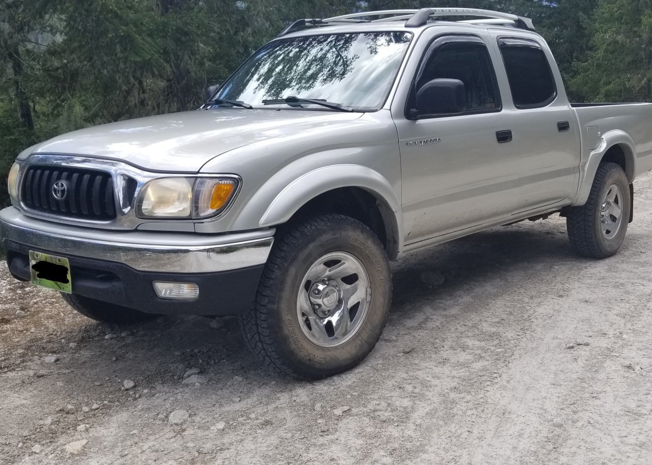

    Hey guys I'm planning on painting my chrome face bar on my front bumper to match my body paint. Just wondering how I should go about this.
    so far my plan is:
    1) wash and dry and sand
    2) wipe down with cleaner
    3) tape off areas
    4) self etching primer then sand
    5) sandable primer then sand
    6) lunar mist metallic paint
    7) clear coat
    Am i missing anything? Don't know a lot about primers. Do I need to use a primer sealer as well?
    I painted my flares recently and just used regular primer and no adhesion promoter and the paint is already peeling off the plastic flares..
    Thanks!

  15. Aug 27, 2020 at 11:54 AM
    eherry17
    eherry17 [OP] Well-Known Member
    Sep 8, 2018
    #265661
    66
    BC, Canada
    2003 Toyota Tacoma
    The end result. Ended up buying primed grille & face bar & painting them.
  16. Apr 6, 2021 at 6:10 PM
    #16
    tuxon
    tuxon Active Member
    Jan 15, 2015
    #146418
    26
    Todd
    Sedona
    02 Tacoma
    I have an 02 Lunar Mist Taco and considering the same. Where did you buy the grille and face bar and what kind of paint did you use?
  17. Apr 6, 2021 at 6:13 PM
    #17
    AssQuake
    AssQuake Unknown Member
    Oct 1, 2018
    #268083
    973
    A.J.
    Washington
    4runner
    Made in Japan
    that looks great! how's it holding up? did u end up using 2k clear?
  18. Apr 6, 2021 at 8:52 PM
    #18
    mbeers6
    mbeers6 Well-Known Member
    Jul 22, 2013
    #108796
    80
    East bay, ca
    03 tacoma double cab 4wd
    Air filter
    Looks really good, interested in what brand you went with for the bumper too.
  19. Apr 7, 2021 at 4:43 PM
    #19
    eherry17
    Sep 8, 2018
    #265661
    66
    BC, Canada
    2003 Toyota Tacoma
    Nice. The grille I got from rockauto (they didn't have lunar mist in stock). Found the face bar on Amazon luckily. I used dupli color for everything.
  20. Apr 7, 2021 at 4:47 PM
    #20
    eherry17
    Sep 8, 2018
    #265661
    66
    BC, Canada
    2003 Toyota Tacoma
    Thanks! Holding up alright. Noo I didn't but kinda wish I did cuz I either didn't use enough clear or didn't wet sand enough. Bumpers great (got a bodyshop to polish it) but a bit of orange peel on the grille. Still looks better than chrome haha.
    AssQuake[QUOTED] likes this.
