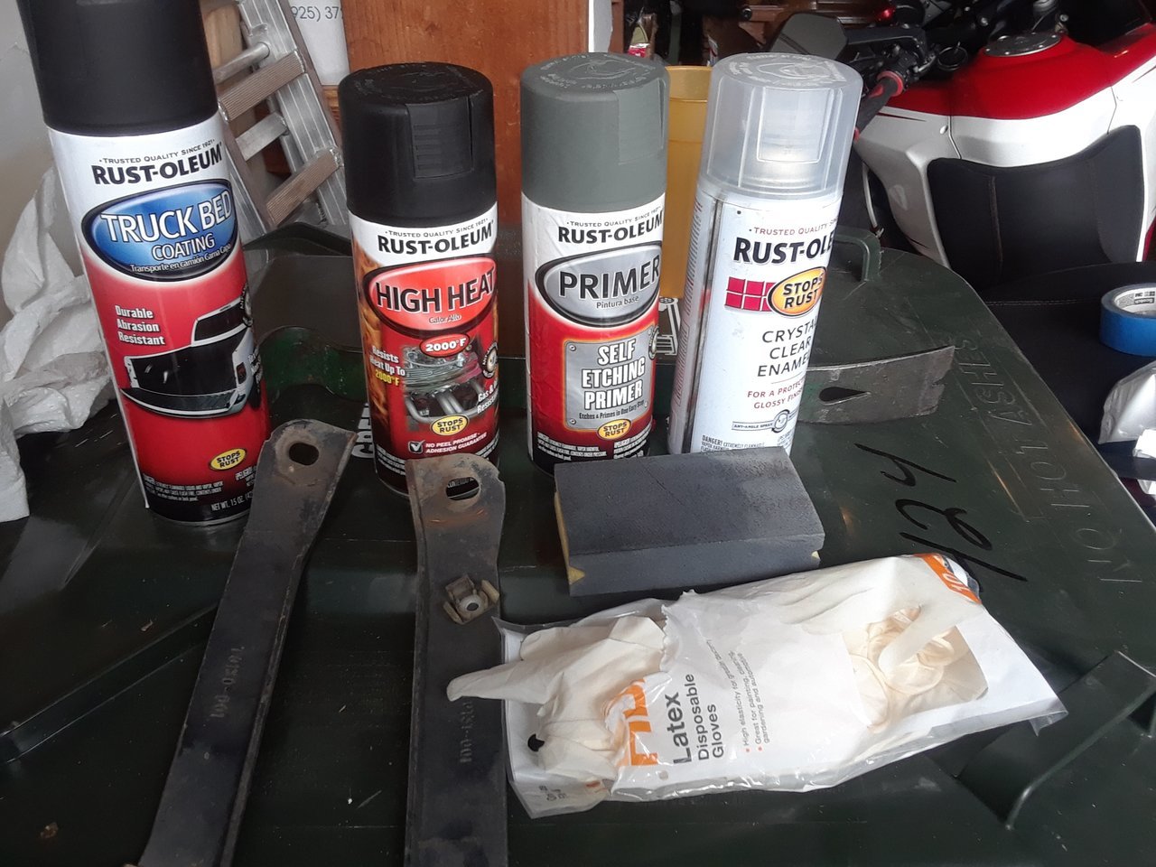

    I sand, use self etching primer, then paint, then clear coat. Might be overkill but holds up great. 20180222_120152.jpg
    jjgandarillas and jlusmc[OP] like this.
