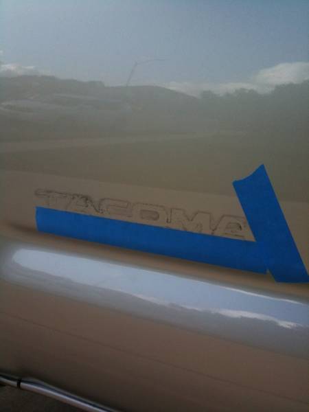

    I started by taping off all my badges like this:
    Then I heated up the badges with the hair dryer on high heat for about 1.5 minutes until it was hot to the touch. I then took the fishing line and started at the "A" in Tacoma and inserted the fishing line behind the badge and in a vertical back and forth motion, began "sawing" off the adhesive from behind. I found that using long strokes works best as it doesn't put too much "wear" on the fishing line causing it to break. If you heated up the badges enough, it almost cuts like butter, leaving you with this:

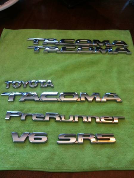

    I then gathered all my badges and prepped them for painting:
    I first sanded them with 320 grit sandpaper (that's what I had laying around the house) to scratch up the shiny finish on all badges:
    Tacoma badge on right is sanded, the one on the left is not

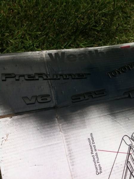

    I cleaned the back of them removing any left over tape and washed all badges in the sink. I then dried them up, took them in the backyard and sprayed a light coat of adhesion promoter (forgot to take pic, LOL). I did 3 coats waiting about 5 minutes between each coat. When they dried, they look like they were frosted/white in color.

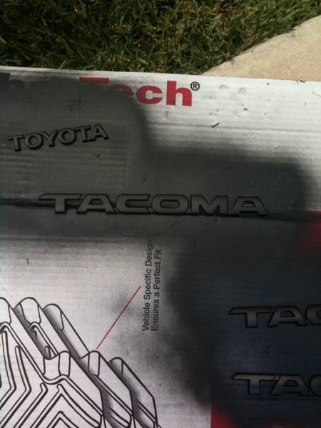

    After drying, I then painted them with the flat black paint:
    I ended up doing 4 coats of black paint with about 15-30 minutes between each coat. After 1 hour of drying, I then applied 2 coats of the matte finish.
