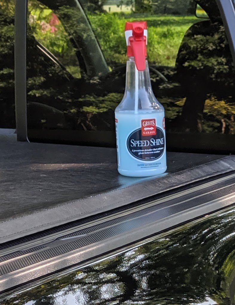

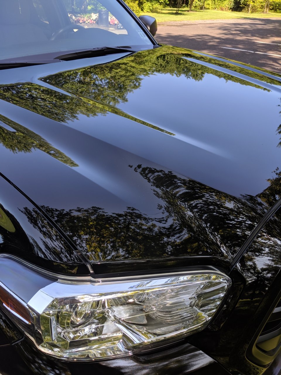

    Do yourself a favor and try this first. This is the only product I use Griots Speed shine. I had buffers, wax all that crap and always ended up swirling the paint on my black vehicles. You really have to know what you are doing with all the stuff. I use speed shine with 3 microfiber towels only, no other stuff. I am not an expert but it seems to really work well without a lot of aggravation.IMG_20190726_094458.jpg IMG_20190726_094536.jpg

    @Yodeville Thank you for your quick response. Your truck looks pristine. I will most certainly try this prior to the "full" detail job. It looks like it's available at my local Advanced Auto store.
