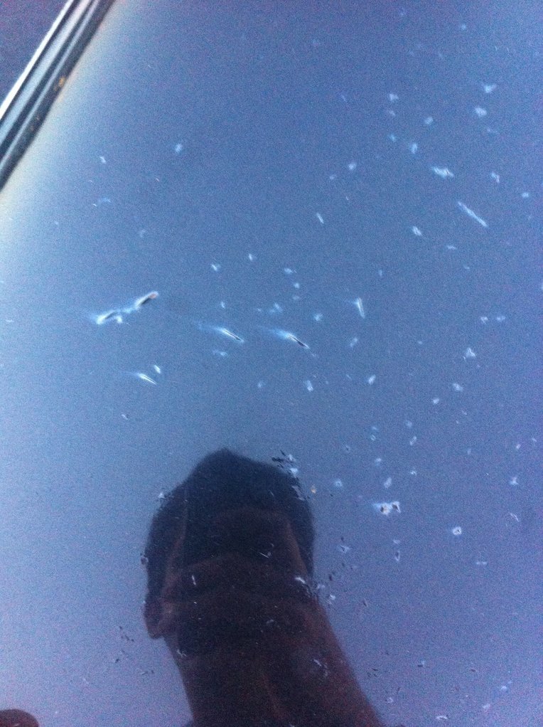

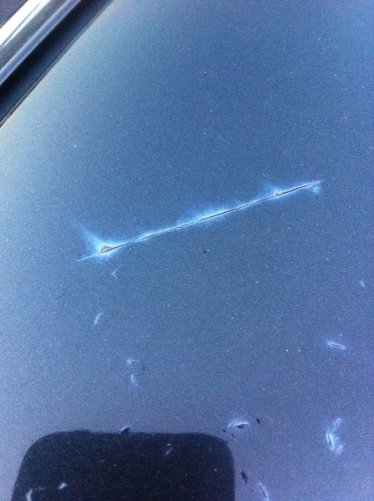

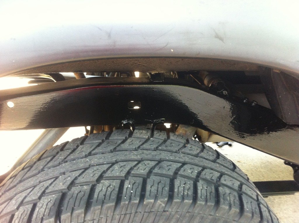

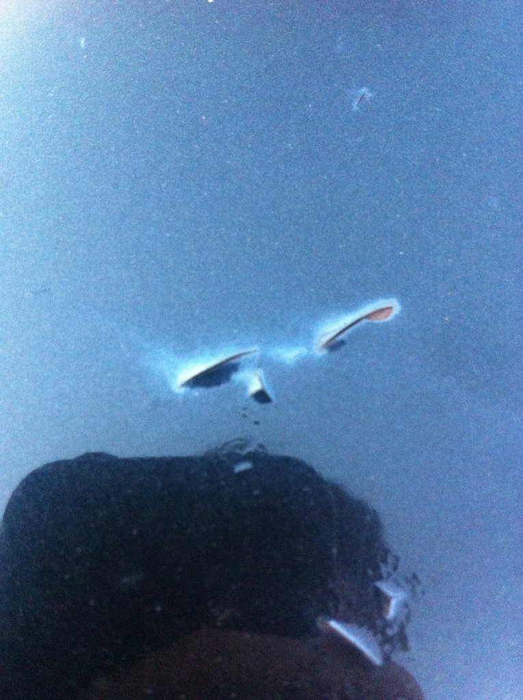

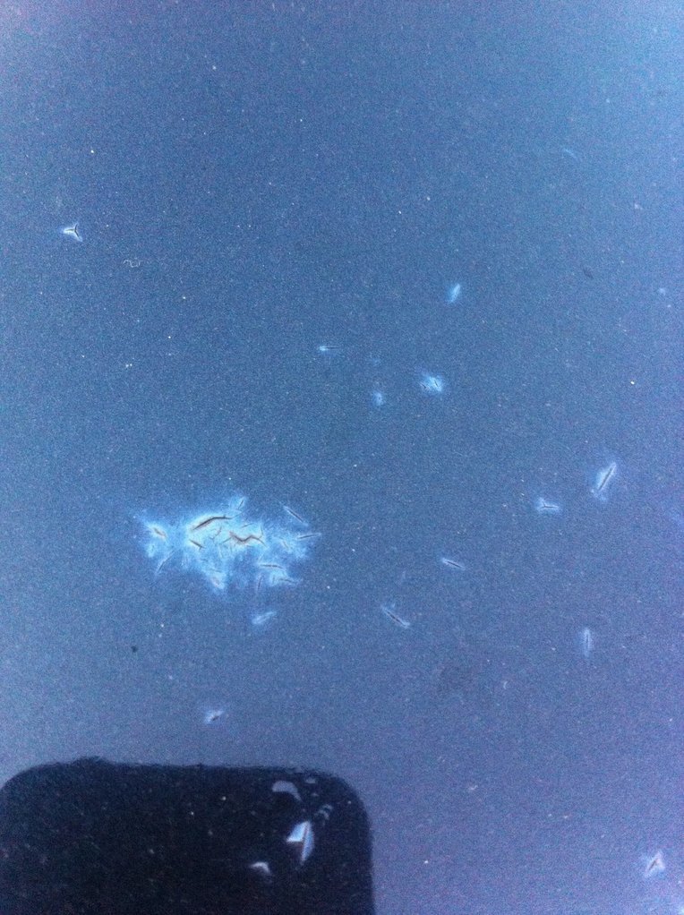

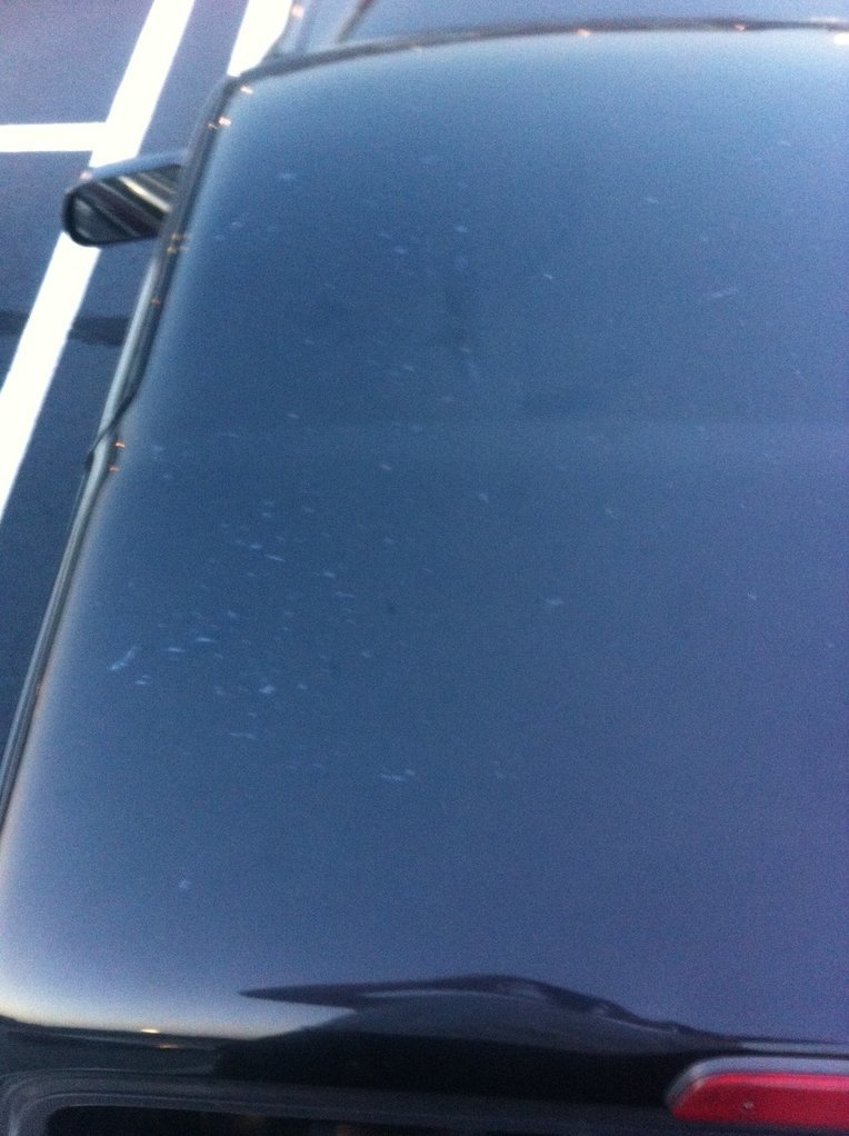

    Hey everyone,
    I haven't been posting lately, recently I have completed painting my trucks frame entirely as shown in this thread : https://www.tacomaworld.com/threads/kbs-rust-seal-review-picture-heavy.374144/#post-10273853
    So I have won my battle against rust on my frame and under my truck but I have found a new "issue". So my trucks paint is black sand pearl, and I noticed this the other day:
    I knew that some scratches on my roof had went to the metal and rusted a little bit. I was wondering what causes this? Is it UV exposure, mechanical scratches, or what? I mean the paint is fine like 95% just those areas where there are scratches. Obviously those scratches don't warrant getting the roof painted, but more or less wait until they get worse to actually go all out. Whats the best way of preventing it from getting worse?
    I have used the Duplicolor all in one scratch fix and it worked pretty well, I got it in the right toyota color too. I fixed the biggest scratch on my roof with it, and it looks decent for being a touch up ( I bet you cant find it in the pictures :) )
    I was just wondering whats the best course of action?
    Thanks

    At minimum you want to try to get as much rust out of the scratch before hitting it with touchup paint. Something like this would help. http://www.amazon.com/Scratch-Brush...4227033&sr=8-1&keywords=Fiberglass+Rust+Brush
    Paint it actually porous. As time goes on, dirt, grease, salt, bird droppings, tree sap, road tar, the sun, etc, attack these pores. This is why we should wax our vehicles. Not the spray on stuff either. A good wax that has to be applied and removed. Whats happening is after it's applied the wax dries in those pores and you're just removing the excess on top. Now when all those contaminates hit the paint they're only sitting on top instead of penetrating into the pore and removing a little bit when being removed. If your paint looks good, but doesnt feel like wet glass when you move your finger across it, you should consider clay barring it before waxing. This removes most of the contaminates and most of the old wax out of the pores as well. People are usually surprised by how amazing their paint feels after a clay bar and wax compared to just a wax.

    Yeah I sanded to bare metal to apply the paint. I personally didn't know it was porous, thank you for the excellent response.
    My one question is, given the condition of my paint with the scratches on top, would wax even do anything and I am assuming clay barring it will make it peal off?

    Yeah the roof is beyond most of that. A lot of places will do just the roof pretty cheaply. It's the most common area that goes bad as it gets a lot of abuse from the sun and from the windshield washer fluid. Another option that could be done fairly cheap, would no longer require wax, and is DiY, is monstaliner. It's a modified, close pored paint that takes a lot of abuse. I've had a lot of people asking abotu my truck say they want to do it to just their roof for the same reasons you have. They have a bunch of colors, and they'll send you like 5 color chips free so you can find one that matches your paint. Only draw back is it goes on with a texture.

    all these trucks have this same issue. my 99 looked like yours for a few months then literally started peeling large strips of clear coat like it had sun burn or something and half the cab roof plus the front fenders and doors had large dull sections with no clear coat left.
    the paint has reached the end of its life after 15 years and the clear coat is degrading and is no longer bonded to the color paint under it so it is peeling off of it. the only solution is to sand all the clear coat off to the color layer and then respray the whole truck because even the spots that still look good will soon go bad as well.
    that said, how well is the color paint still bonded to the metal so if your going to the trouble to sand all the clear coat off, you may as well do it right and go to bare metal so you know the new paint will last another 15 years.
    instead of repainting I traded minre in on an 04 but im expecting it will need a paint job in the next 4-5 years because that seams the limit to how long the factory paint will last

    2,831
    chris
    san diego
