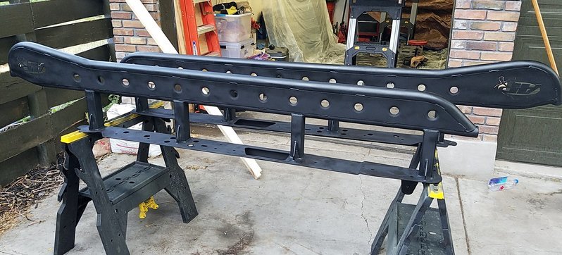

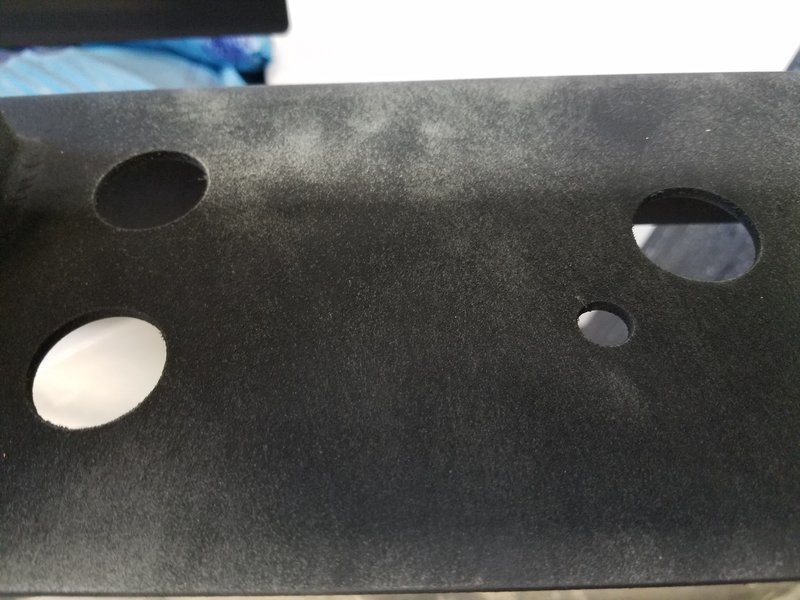

    Just got a set of sliders, prepped them with a metal brush on angle grinder, wiped down with acetone and sprayed Rust-Oleum self etching primer, couple of coats. Waited for primer to dry less than an hour and applied a couple top coats of textured black. Went out to the garage today and on one whole section the paint just comes up like dust to reveal primer if I run my fingers over it. It's the plate section that faces out from the truck that sits against the frame rails. Other areas like tubing and such it seems like paint is adhering just fine. Any ideas on why this would occur? Should I start over from scratch or just wet sand the problem areas and hope for the best? Tempted to start over as I'm worried something is up with overall adhesion of the paint.

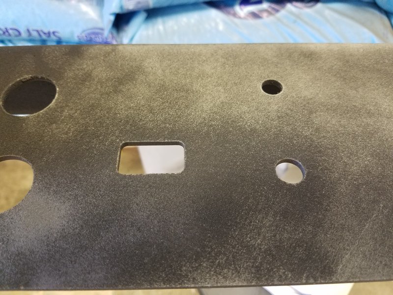

    This sucks, still not sticking. Maybe I'll wait a bit, wet sand and recoat. This is after drying for 24 hours, rubbed my hand against it and it literally comes off like dust. It's the only area it's happening, but it's the same area on both sliders. Primer seems to stick ok, just the top coat isn't adhering. Doesn't make sense!

    I think I got it solved, looking like adhesion is better. Could have been two things causing the issue, not letting self etching primer dry long enough before spraying top coat or not sanding primer prior to spraying top coat. Took the following steps:
    • Wetsanded Top Coat with 400 grit
    • Washed with soap and water
    • Dried with compressed air
    • Wiped down with Grease and Wax Cleaner
      • Applied with wet rag, wiped with dry rag
    • Used tack rag to remove lint
    • Let dry for an hour
    • Sprayed top coat
