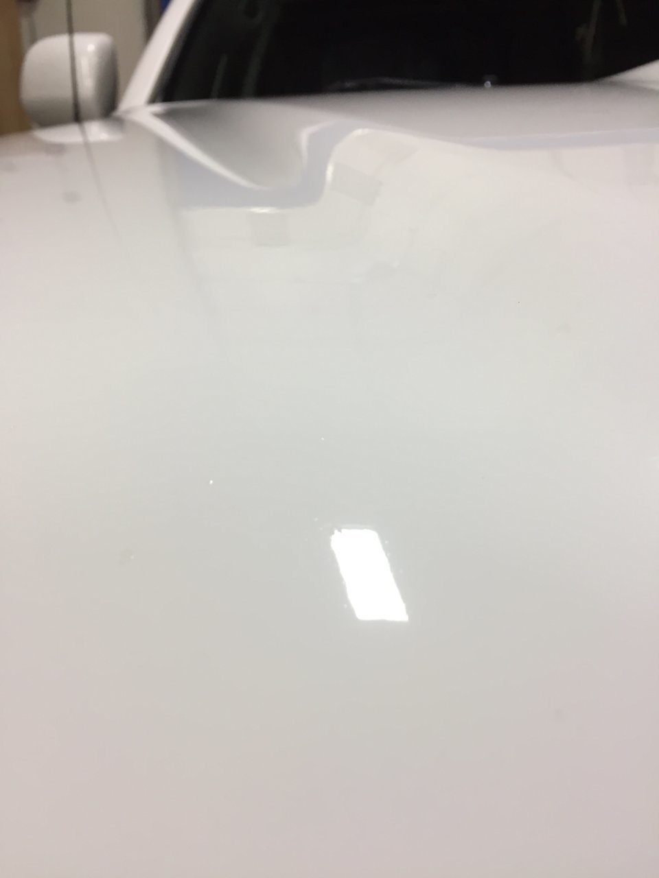

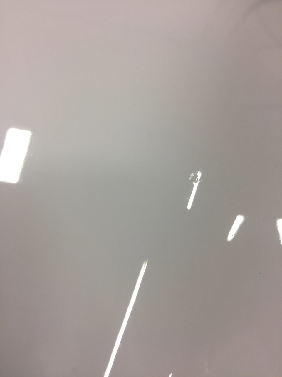

    1. I washed and clay bar the vehicle. Not 100% necessary, but it helps me to take note of potential work areas as well as remove anything in the paint that may be mistaken for damage.
    Here is a rock chip on the hood:

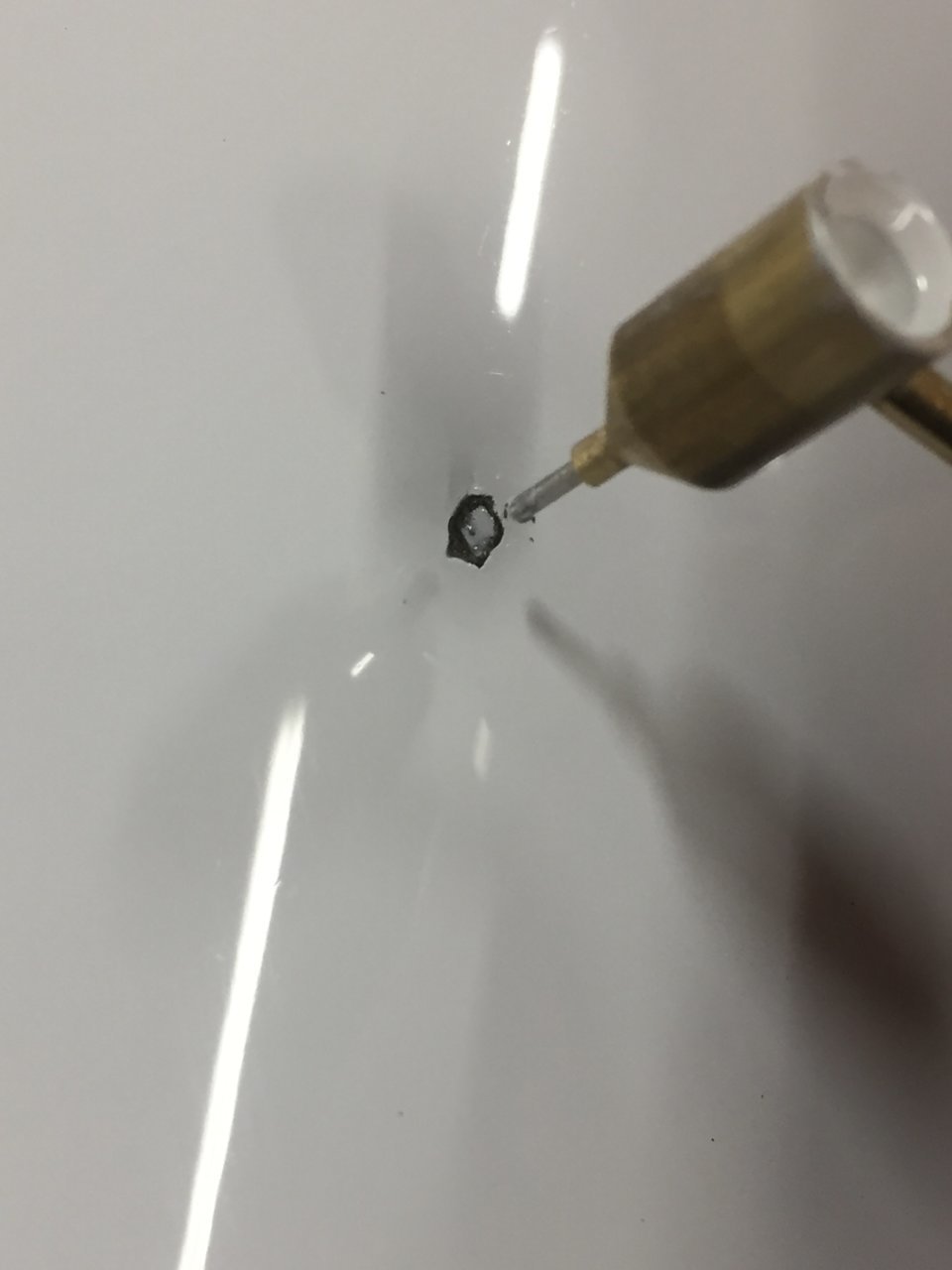

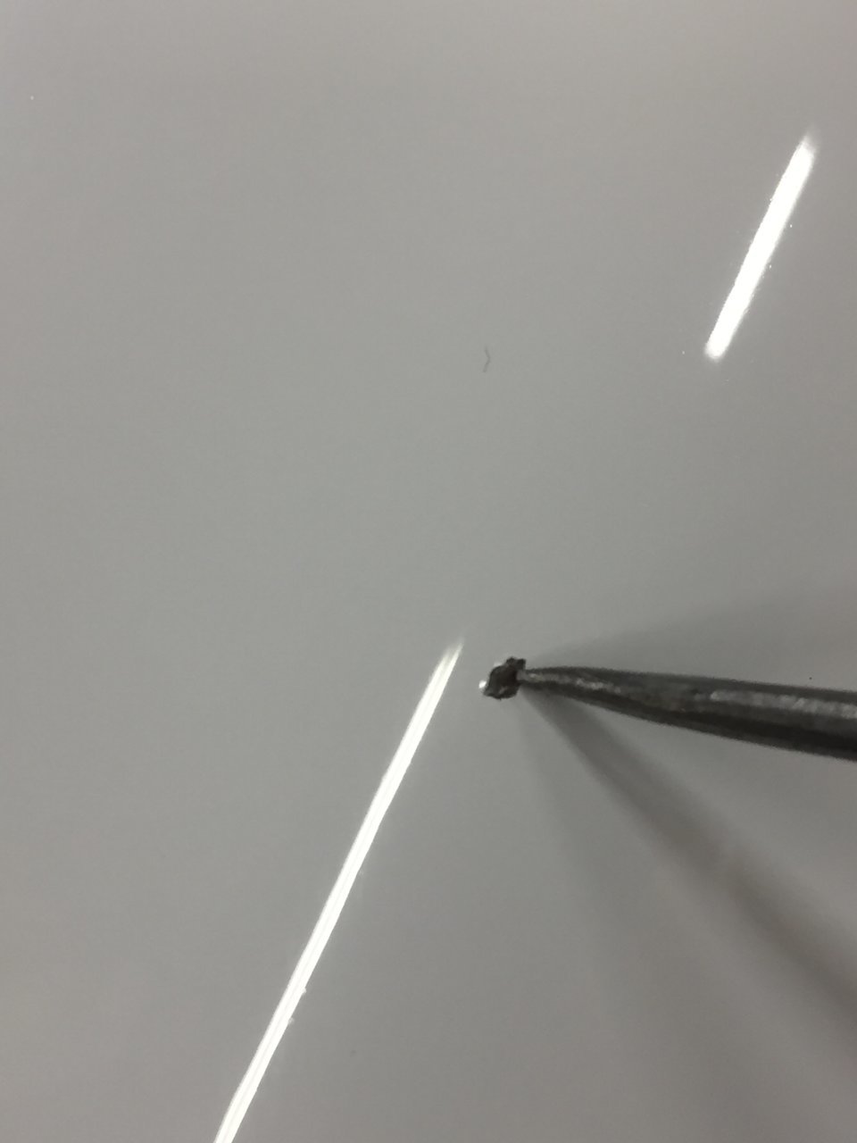

    2. I used a pick tool to flake off any loose paint as well as rust, then prepped with alcohol. I’m doubtful that if I simply covered up rust, that it would make its way to the surface anytime soon. However, if it’s worth doing at all, you might as well do the prep work to the best of your ability.

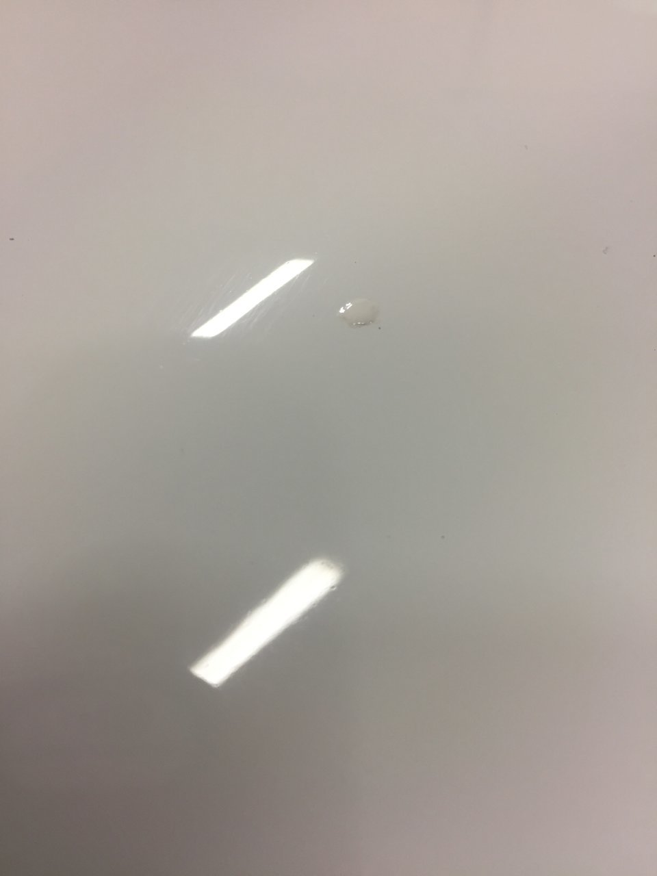

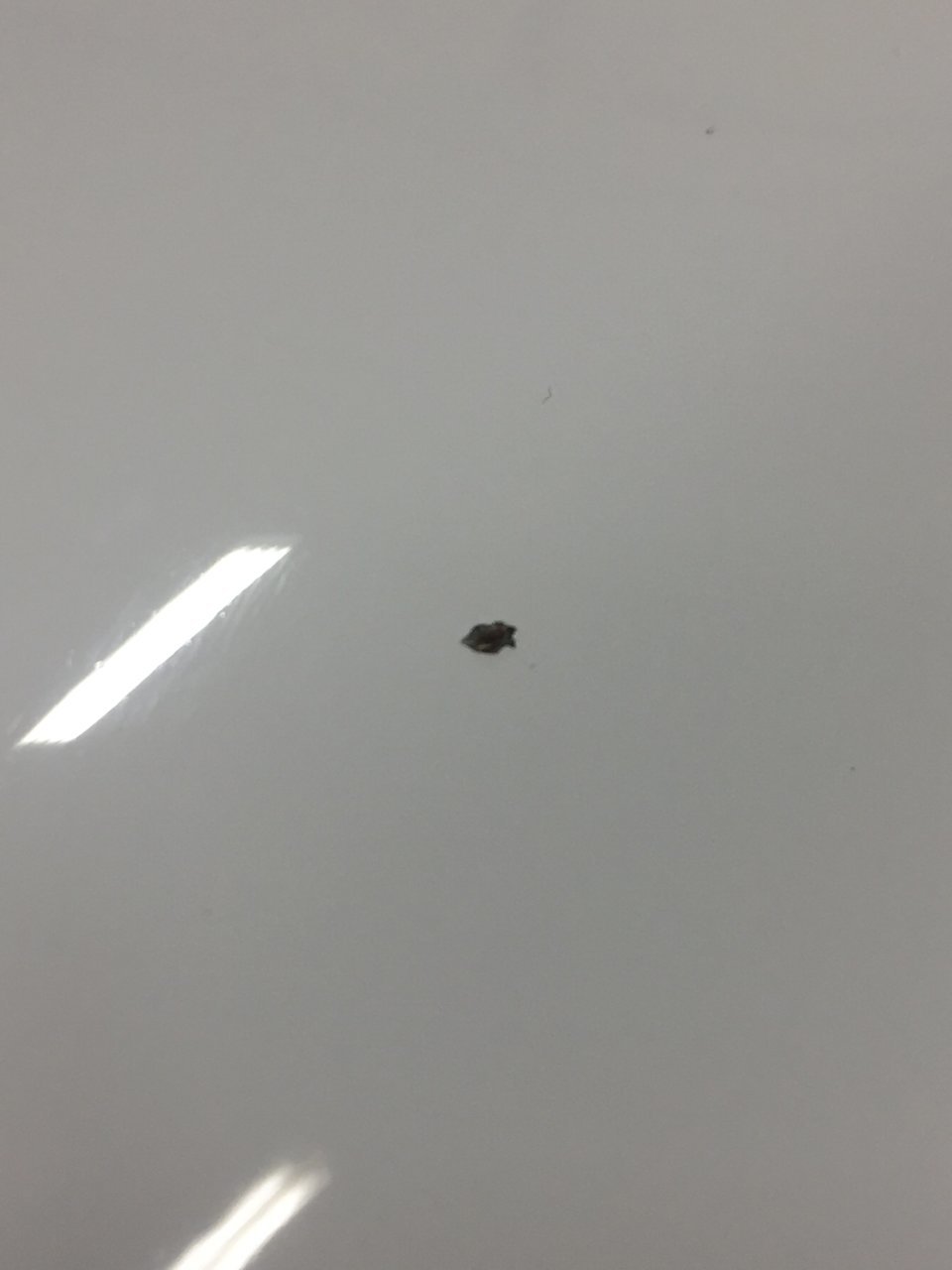

    3. Use the paint pen to fill the chip. I used a layering technique rather than immediately filling the chip above the surface level. This requires some finesse, because the previous layer must have time to set. Touch up paint is cured with air rather than hardeners like the factory paint. A heat gun can be used to accelerate the process, just be careful and keep the gun moving. If you don’t wait long enough between layers, the paint gets clumpy. Be patient and move around the vehicle if you must.
    Very fine paint droplets
    A complete first layer
    A second and third layer
    Note that the touch up is now above the factory paint. Let this set up. I gave it an hour. The touch up was unaffected by my finger nail after curing.

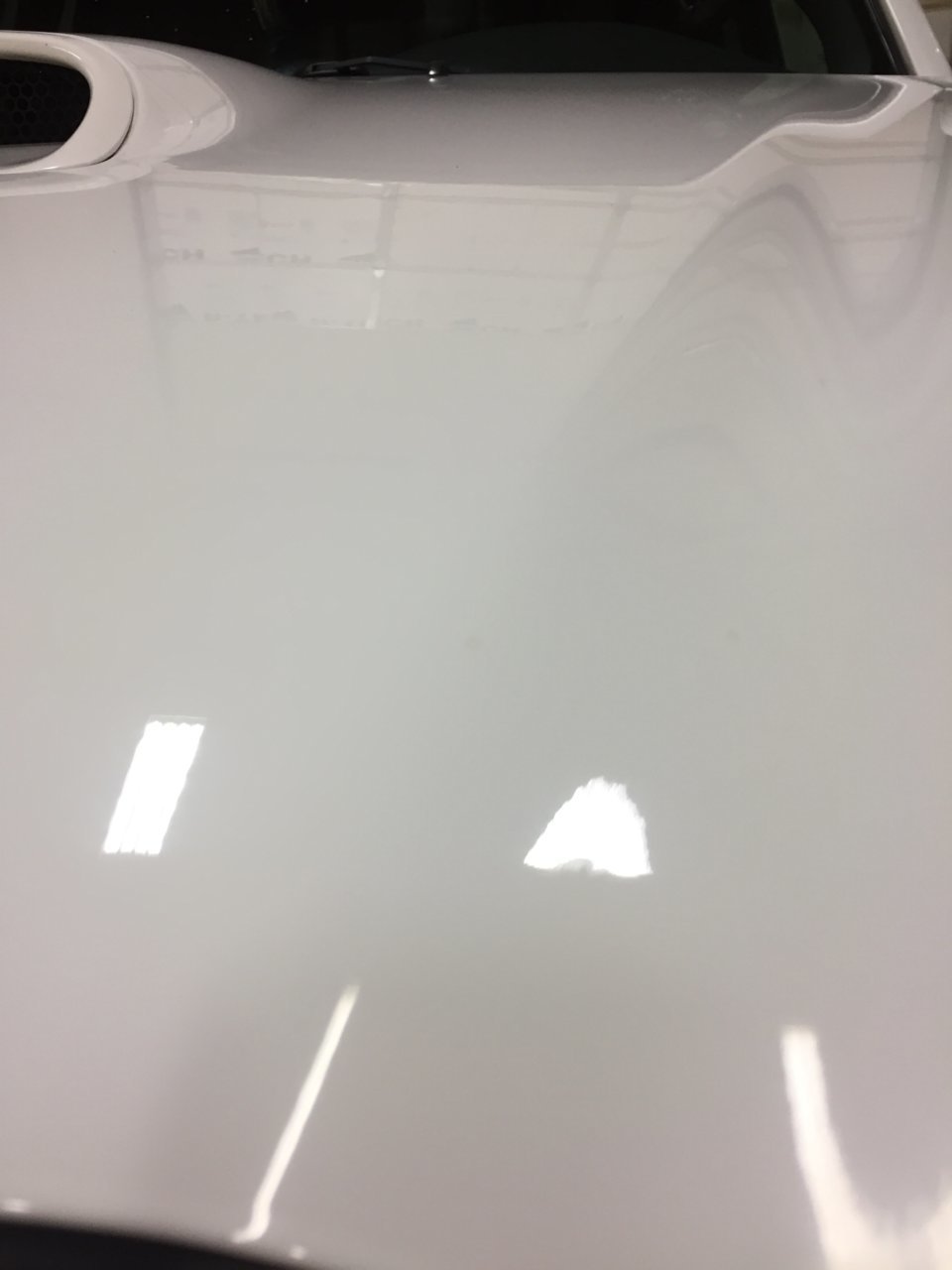

    5. Polish and wax the repaired area. I ended up doing my whole hood. The wax will help protect the touch up. OEM touch up paints can vary in type and quality. It is best to protect them whenever possible. They are not bonded to the metal in the same way the surrounding factory paint is.
    Repair is in between rectangular and triangular reflection.

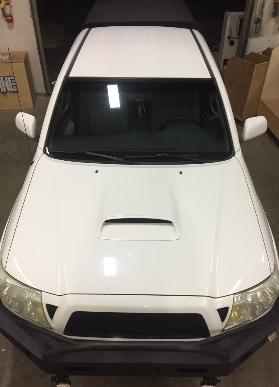

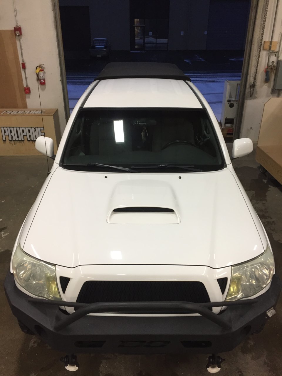

    As I previously mentioned, I used to be very meticulous about paint care. As for right now, I’m saving all that effort for when I own a brand new vehicle. This truck is never going to be spotless, but it did deserve some effort to make it look less neglected. I only spent about 2.5 hours on my whole hood. You could honestly spend all day doing this and getting it perfect.

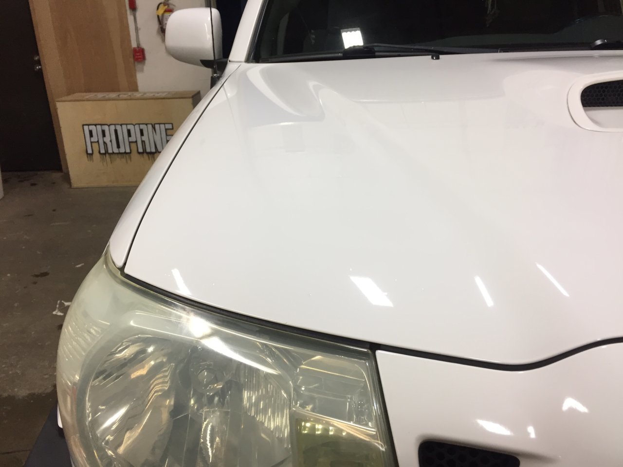

    I give the finished product a 7/10. It is much better than before. However, color disparities and slightly different surface finishes allow the touch-ups to show when light directly reflects off of them.
    Large chips visible bottom left by headlight
    No chips visible from about 6ft.
    Wax really helps hide the repairs
