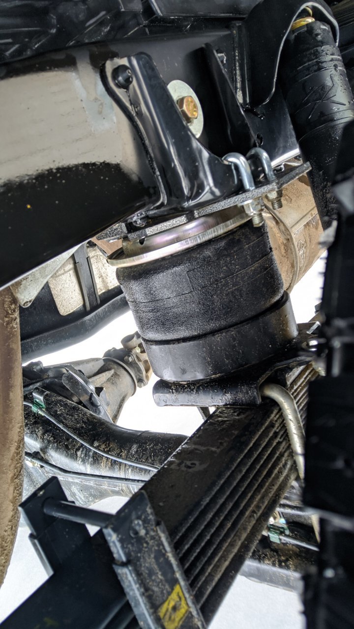

    Driver and passenger side brackets needed some major modification to fit properly. I did this about a 3 weeks ago. Its fits right now.
    Driver side: Two issues.
    1. the brackets are too wide to fit between the U-bolts and the brake line bracket. I had to shave off 1/16" - 1/8" to make it fit.
    2. the portion where the air spring sits on sits waaay to close to the leaf spring, allowing very little room for the brake line to pass through. I had to cut and weld to relocate the side portion by 1/4". This gave it alot more room for the brake line to pass through and voiding extreme angles.
    See below images for reference.
    153CAD80-98A9-4BE2-98EE-969E5FFD39D4.jpg 43C16B5B-493D-474E-B6A0-2E9812E0757F.jpg 5C9CE905-3636-4D03-A2B1-41C133E22997.jpg
    Passenger side: One issue.
    1. The air spring mounted sits really close to the exhaust pipe. It was rubbing against the suppplied heat shield. I reduced the bracket overall width by 1/4", which offsetted the air spring out board so it doesn't rub the supplied heat shield.
    Overall, the kits mounts require modification to fit. I don't know if my U-Bolts are bigger than OEM since i'm using OME HD leaf packs - which added to the mods needed. But still overall the mounting brackets are a tight fit. Even if everything was OEM, the brackets would still needed to be modded. The air spring themselves, seems quite nice. On jacks, it seems i can get full droop travel, and looks like it won't interfere with full compression. So it seems theres full articulation - although I haven't done any real wheelin to test it yet.
