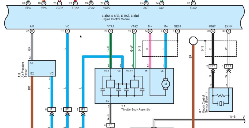

    I Think this is the sensor you are looking for on the left side of the print. I sent you a complete copy.
    The Diagnostics:
    The AID drives the ASV and the air pump according to command signals transmitted by the ECM. The pressure sensor detects the pressure in the secondary air passage when the AIR system is ON and OFF, and transmits pressure signal to the ECM.
  5. Oct 5, 2016 at 1:18 AM
    Jimmyh
    Jimmyh Well-Known Member
    May 16, 2012
    #78991
    14,198
    SC
    2012 Prerunner SR5
    This is a diagram from the service manual:

    Thanks Jimmy. That pressure switch is not just a NO or NC switch, so it's not as simple to check as I had hoped.

    The small hose from the ASV goes to a switch/sensor in the back side of the air intake tube, before the TB. That must be the pressure sensor, right? It only has 2 wires going to it, but that schematic is showing 3 wires. I'm confused. :annoyed:

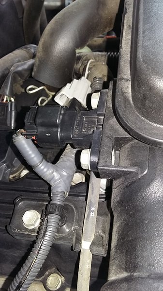

    I may just pull it off tomorrow and stare at it real hard, may make it start working.. :) Just so I know for sure I am looking at the right sensor I'm going to post a picture. This is a 2010 2.7L.

    Pressure Sensor harness is open or shorted.
    Fucking packrat! After I got the connector unplugged, which was a challenge in it self, there are indeed 3 wires into that sensor. A packrat had bit off one wire and ate about a quarter inch of it so I didn't see that it was gone. There are three wires where I could only see two. It was bit off so close to the connector that I had to trim into the rubber part of the connector to maybe an eighth of an inch was sticking out. With a pencil iron I was able to get a good joint. It only took 2 tries! a record for me. :)

    With the helpful information that you all above posted, I located the connector to the sensor, and there was a pile of tree seeds and nut shells there, and one of the wires had been chewed through! (The middle gray one, in the photo above.) I repaired the connector by cutting a section from a sewing needle and stuck one end into the cable wire end, between the insulation and the wire metal, and the other end of the needle I inserted into the stub of the chewed through wire on the connector. Then I put a lot of Shoo-Goo adhesive all over it, and wrapped it with a little Gorilla tape and re-inserted the connector. If it didn't work, or last, I figured I could purchase a connector and/or cable for a more permanent solution. However, it worked fine, and I've been good to go for almost a year now!
