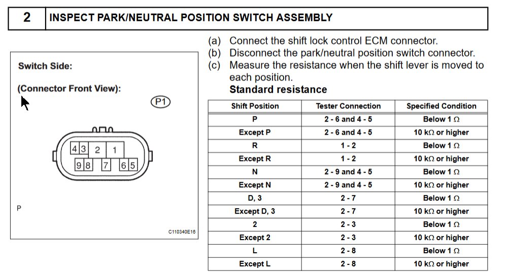

    P0705 CEL
    DESCRIPTION
    The park/neutral position switch detects the shift lever position and sends signals to the ECM.
    MONITOR DESCRIPTION
    These DTCs indicate a problem with the park/neutral position switch and the wire harness in the park/neutral position switch circuit.For security, the park/neutral position switch detects the shift lever position so that the engine can be started only when the vehicle is in the P or N shift position.When the park/neutral position switch sends more than one signal at a time from switch positions P, R, N or D, the ECM interprets this as a fault in the switch. The ECM turns on the MIL and store a DTC.
    The only tie in I could think of between this and the tail light assemblies would be the reverse lights. A short or a defective connection could cause a power loss and defective signals to the ECU.
    You can check the Harness and the switch if you have a DMM
    Check the Park Neutral Switch:
    Check the Park Neutral Switch Harness:
