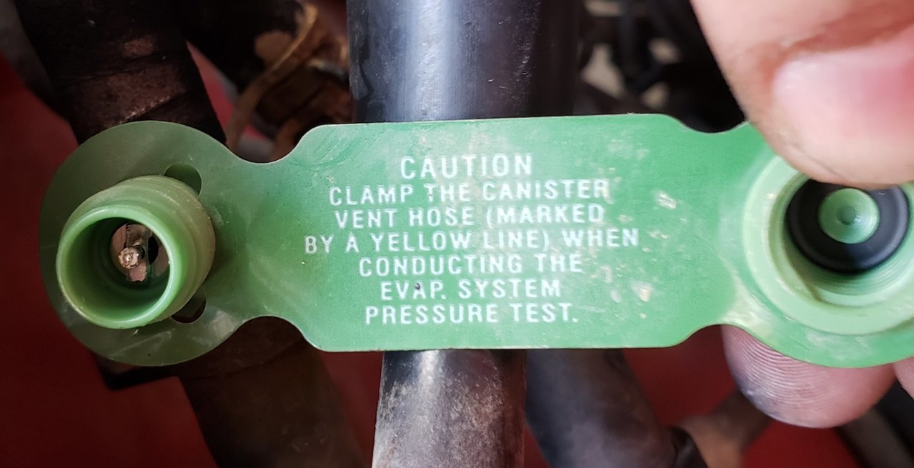

    My initial thought was bad gas cap seal, so I cleaned the mating surface of the gas cap on the filler neck, cleaned the cap itself, and cleared the code. No dice, It came back shortly thereafter. So I bought a new OEM gas cap. That didn't work either, code returned. I checked the EVAP VSV valve by disconnecting the hoses and attempting to blow through it unpowered and powered. Seems to be working correctly, not leaks could be felt. Next I bought a used DIY smoke machine and connected to the hose with the green service port. I saw smoke pouring out of the area around the gas cap (see grey arrows in photo). Since I had already replaced the cap, I assumed the filler neck was bad. So I replaced it with a new one and did the smoke test again. The smoke came out of the same spot. Examining the old filler, I now suspect that may be a vent of some sort.

    • I read the service port tag under the hood, it says to block the canister vent marked by a yellow line (see photo). I don't see that line, does anyone know which on is the vent? I suspect it may be that same line.

    P0441 is for a small leak. Essentially the system has closed itself off after pulling a vacuum and measures pressure rise after a defined period. Depending on the pressure rise you either get a small leak or a large leak. During positive pressure testing via the evap port, you must block off the air drain hose. The charcoal canister has check valves that open during positive pressure to vent fuel vapor. This is used during fueling to allow vapor pressure to escape the tank, pass through the canister, then go to atmosphere. The confusing part to me on these trucks is that the air drain hose appears to route back to the fuel filter neck. My suspicion is that the gray piece on the fuel neck is separate from the fuel flow path. I would clamp off that hose near the charcoal canister and repeat the smoke test.

    For anyone else reading this later who might be in the same spot: Clamp off that line in the red arrow (see my photos above). I also pulled off one of my smaller filler tubes that leads to the tank. I think this helped fill up the tank with nice thick smoke. Then when I reconnected that line I pulled off, the thick smoke starts to come out of the leak location and becomes more apparent. Hope that makes sense.
