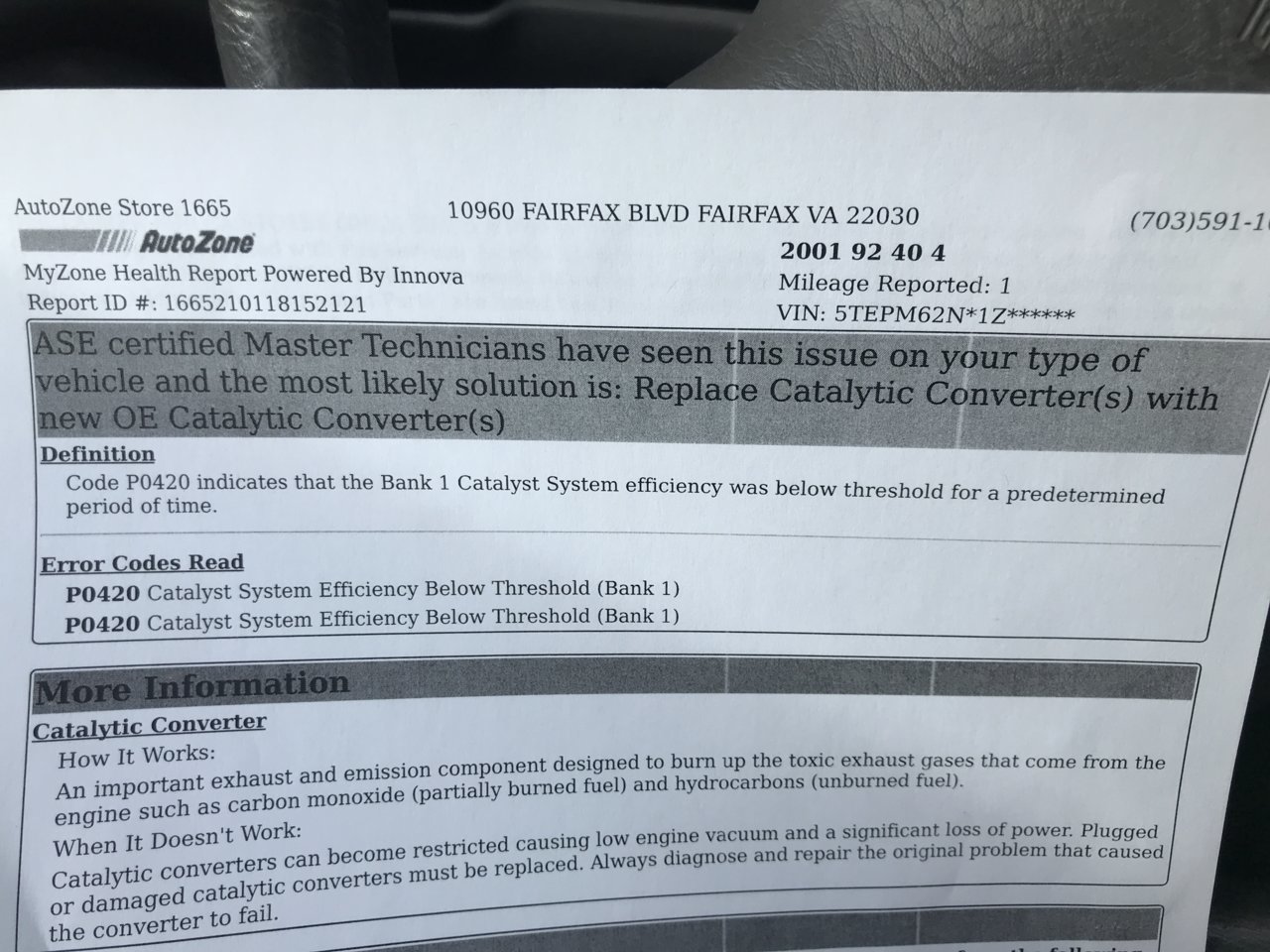

    Greetings,
    i have Tacoma 2001 2.7L 2 doors base, I changed the muffler but because the muffler was very rusty, the mechanic had a hard time to remove it so he had to hit with the hammer and kept shaking it so it finally came out and he was able to put a new one but then after driving it I got the check engine light! So I went and changed the downstream O2 sensor but still the check engine light still there, so what do you guys suggest? Should I change the Catalytic converter Bank1? If so, which one is Bank1 front and or rear? Do you have any suggestion from where I get the part for a good price online?
    Thank you so much for your help

    Hello Adam
    Welcome to TacomaWorld
    The 4 cyl 2.7L only has 1 bank.
    Sensors are B1S1 upstream before catalytic converter. S1 on 2001 2.7 is an air/fuel sensor not associated with catalytic converter.
    B1S2 is downstream O2 sensor which measures catalytic converter efficiency by measuring remaining oxygen in exhaust gas after combustion in catalytic converter.
    Exhaust leaks upstream can throw P0420.
    Check for leaks at manifold and Ypipe donut gasket where Ypipe bolts to catalytic converter.

    this code is not self clearing... see if auto zone can clear the codes for you. If it comes back on in a bit get back on the forum.

    I did clear it and it came back after I drove it for 40 miles!
