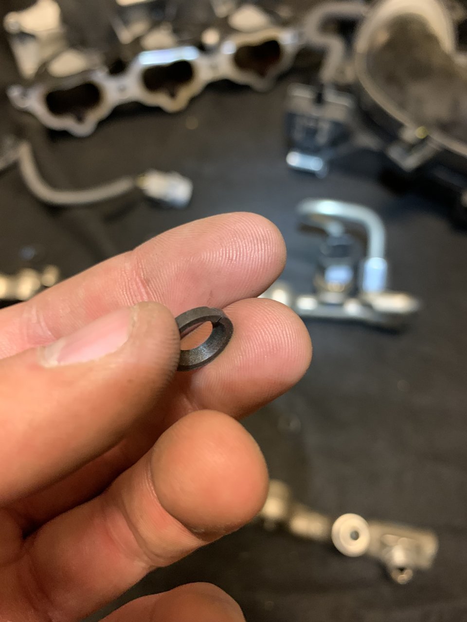

    Came back from a trip and had a P0328 code for knock sensor bank 1 high input. Sure enough, rodent chewed through my knock sensor wire.
    As I was taking the lower fuel rail off, I accidentally dropped one of the injector o-ring spacers. It the hard plastic split washer that sits directly on top of the lower injector. It’s flat on oneside and concave on the other.
    Does anyone have a part number for this? Maybe even the whole seal stack (from bottom to top: plastic split washer, large black o-ring, small blue plastic stopper)? I’m in this deep and don’t want to tear it all back apart if I messed up a seal.

    Thanks for the link. I’ve searched through that page a bunch but I’m not sure what the correct part number is without a diagram or photos. My best guess is its 23256-31010, but I’ve seen a similar looking part pop up under 23258-31020 (and other 23258- part numbers)

    Resurrecting an old post but I'm in same situation looking for these parts. I will post back as REF when I find the correct part#'s for the stack. OEM only
    Here is the lower injector stack parts for future ref...
    23256-31010 : Ring, Fuel (as shown in post above)
    90301-05011: Ring, O
    23258-31020: Ring, Fuel (the blueish top ring in the stack)
