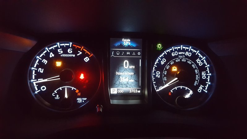

    Why am I getting a check engine light? Also Trac Off light is on. I've got less than 4k miles. Auto shift. It seems to kick when it shifts gears and has trouble going up hills. Just started happening.
    Any ideas?
    I've added an OEM+ audio system a few weeks ago. Sub, Speakers, Amp. I took the fuse out to test and see if that had something to do with it. Seemed to not affect anything. Question, will that void my warranty? I'm assuming it wont.....
    I'm going to bring this thing into the dealer tomorrow but any advice or troubleshooting ideas would be greatly appreciated.

    It would be incumbent upon the dealer to prove that somehow the OEM+ system had a lick of hair to do with a knock sensor code. Which, may I add, would be very difficult, if not impossible to prove. Interior modifications would have very little to do with a powertrain issue, even if they noticed you had changed anything. Take it in for service.

    Bad fuel can caused knock sensor codes. Mechanical engine noise can set the codes. or it could be an electrical problem.

    maybe CPS too... fuel rail issue too maybe an issue with an injector. Time for service..let Toyota figure it out. Probably more codes you don't see.

    Turns out that rats ate my wiring harness. They found a rodents nest and the harness was all chewed up. Not covered by warranty, and insurance will pay for a total of $60 out of the $560 it will cost to replace it. Anyone else have this issue? Got ideas for how to keep the little bastards from nesting in your new truck?
