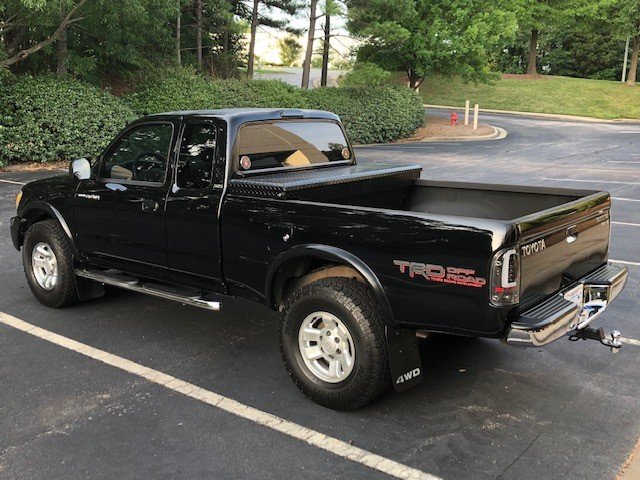

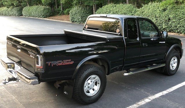

    Over the span of a month, I've made 4 trips to the dealership for a handful of EVAP codes; sensor, chip, charcoal module and some other part. Researching online tells me: P0301 indicates that cylinder number 1 is experiencing misfires. A misfire occurs when an insufficient amount of fuel is burning in a cylinder. I'm keeping the truck, so when things happen, I've always addressed them with a sense of urgency. If you've dealt with this could you share your fix?

    What a great looking 20+ year old Tacoma! If the undercarriage looks as good as the rest of your truck you are clearly doing something right. To some @Wyoming09 may have just been stating the obvious but he is spot on. There are some real experts on this site, I hope several will jump in and give you actionable advise to help pinpoint the cause. Good luck!
