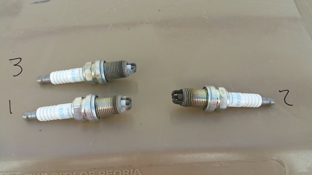

    So this morning started working on it. Pulled plugs I replaced in the middle of May(~7k miles ago) and found cylinder #2 was pretty black.
    The other 3 plugs look similar to the #1 and #3 plugs.

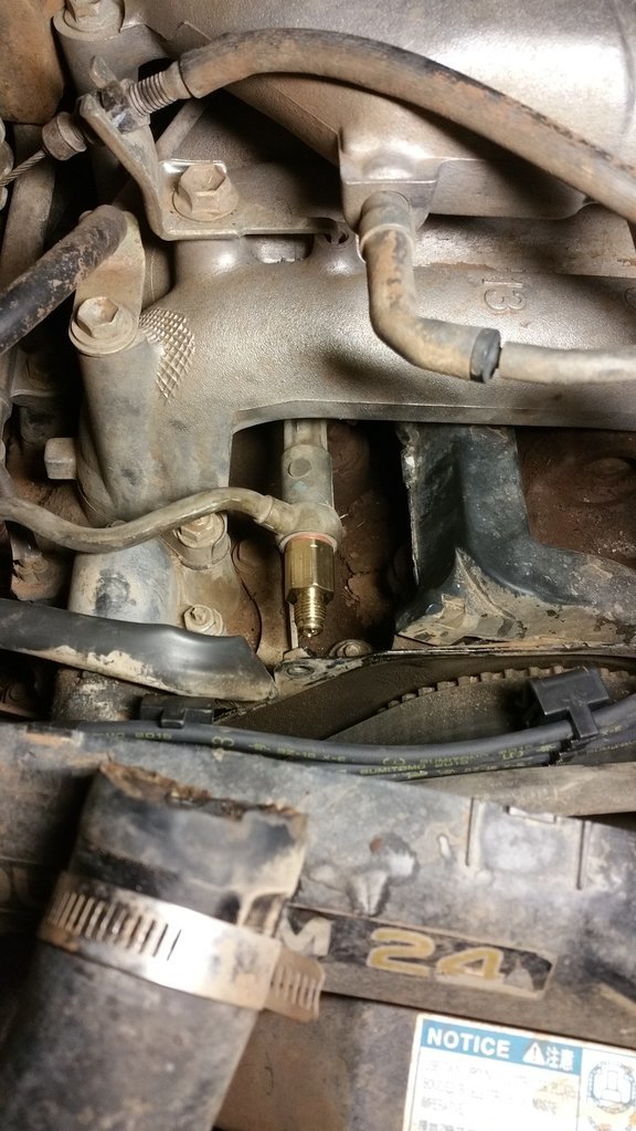

    So replaced the main vacuum hose that was broken as well as the one that I found was cracked. I also got into the spark plug wires and replaced those with OEM.
    Unfortunately I wasn't able to get into the fuel pressure. The kit I picked up from autozone didn't have the right fittings needed to make it work. I need 90* fitting right after the injector rail. The kit had a straight fitting that would connect into the 90*, but I ran out of space with the back piece of the timing belt cover. Any one know where I can get the correct fitting?

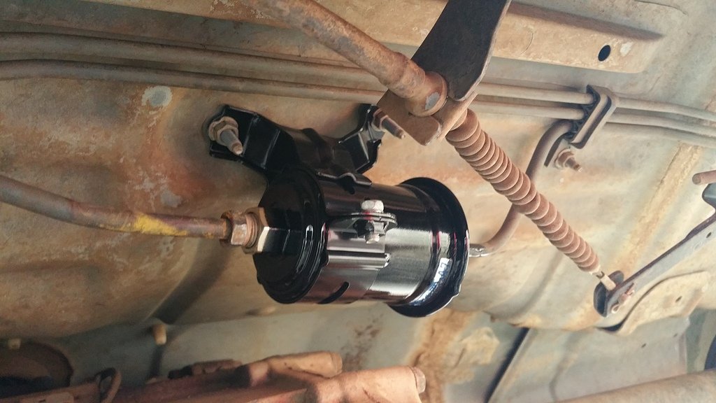

    Today I cleaned TB, checked the IAC and TPS, re-checked coil packs and wires, replaced the fuel filter and put the truck back together. Everything has checked out fine besides the fuel filter it seems. I have it leaking on one side and not the other. I have run out of time for today, but I'm going to replace the oil filter and see if it still leaks.
    Good side
    Leaky side

    So the truck is up and running and doing a lot better. I swapped out my old filter and started it up. No leaking from the filter. I finished filling up my radiator and rechecked everything. After sitting about 10 minutes and driving about 25 miles, everything seems to be running well. No CEL codes have shown up either.
    Seems the issues was the plug wires, dirty throttle body and the vacuum hoses.
    Thanks for the help guys!

    You can screw an 1/8" NPT 90 deg fitting into the end of one of these.
    http://www.autozone.com/fittings-an...110-and-641120/773861/?CJPID=2206300&cmpid=cj
