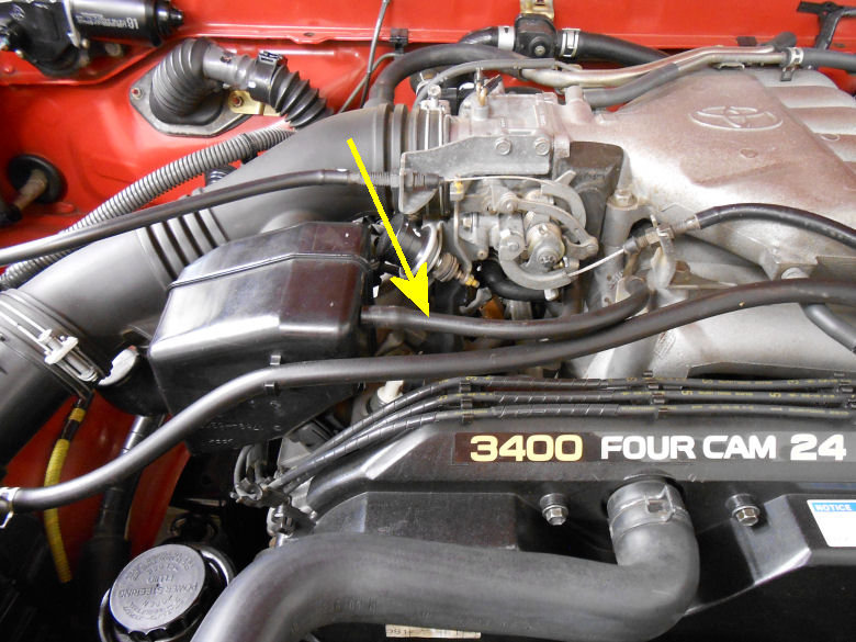

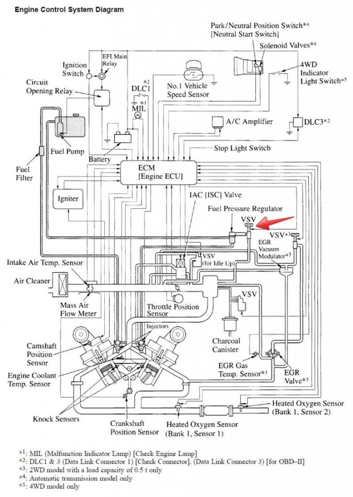

    I kinda figured you would say that ;). The FSM is 100% wrong (misprint). I think the page is an artifact from the very very early V6's. They had the feature to aid hot restarts. The ECM controlled a VSV that controlled vacuum to the FPR. This feature was dropped very early on.
    In all the rest of the "bone stock, unmodified, just the way the factory built it" systems the "vacuum" line goes to a port on the resonator box upstream of the TB and will see no vacuum at all. Gadget recognized this as early as 99.
    Since you took the time to post up the page from the FSM and apparently do not have a V6 handy to check for yourself, I will go take a pic.
    Here is a Toyota diagram of the early system (red arrow).

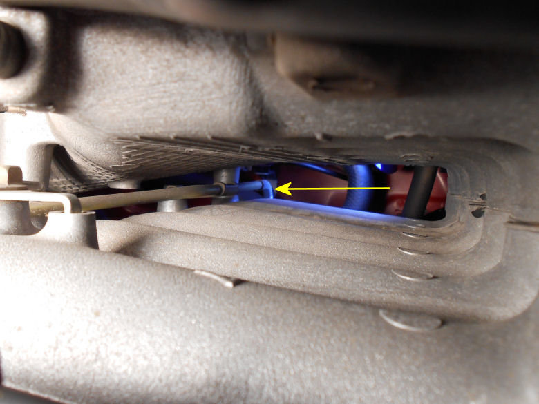

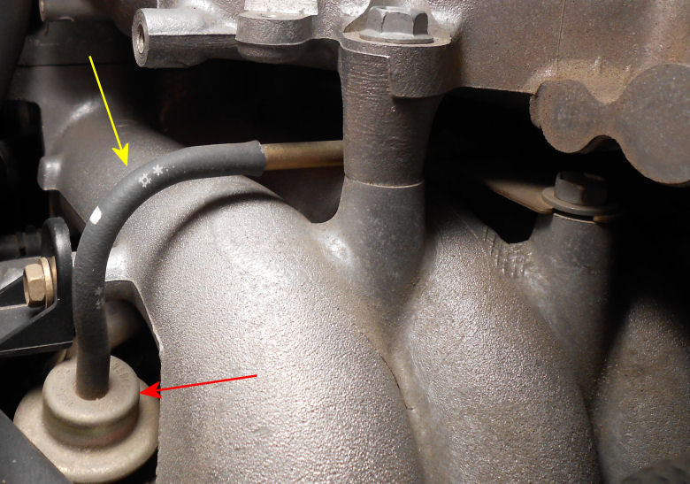

    From the yellow arrow the line transitions to a steel tube, (just under the throttle cable mount) goes between the folded intake runners then transitions back to rubber and plugs into the FPR. The camera will not fit in there.:) EDIT, got the little camera in there.
    Resonator box
    Steel line under runners with rubber 90 deg bend at the end.
    Same rubber 90 entering FPR.

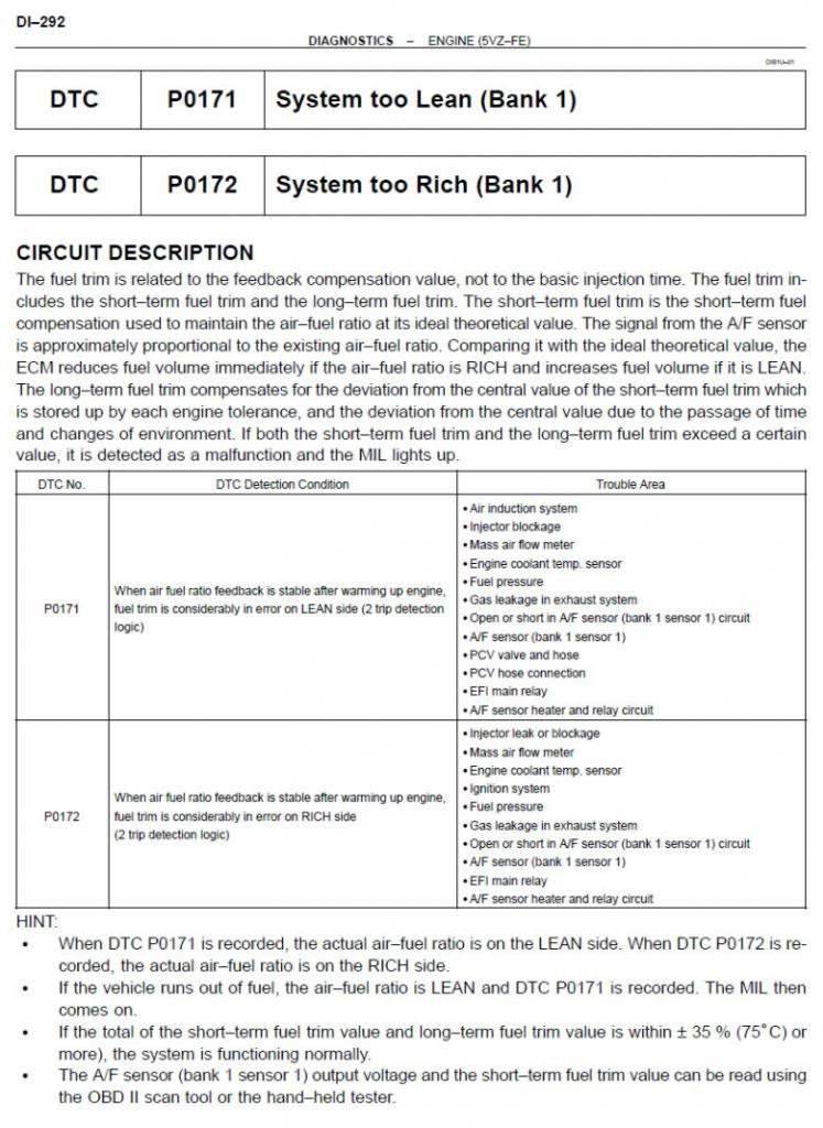

    The initial diagnostic FSM page below is from an 03 but it is the same as my 99 paper one. The further testing procedures differ substantially between the 2 years.
