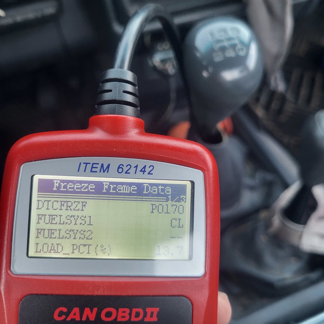

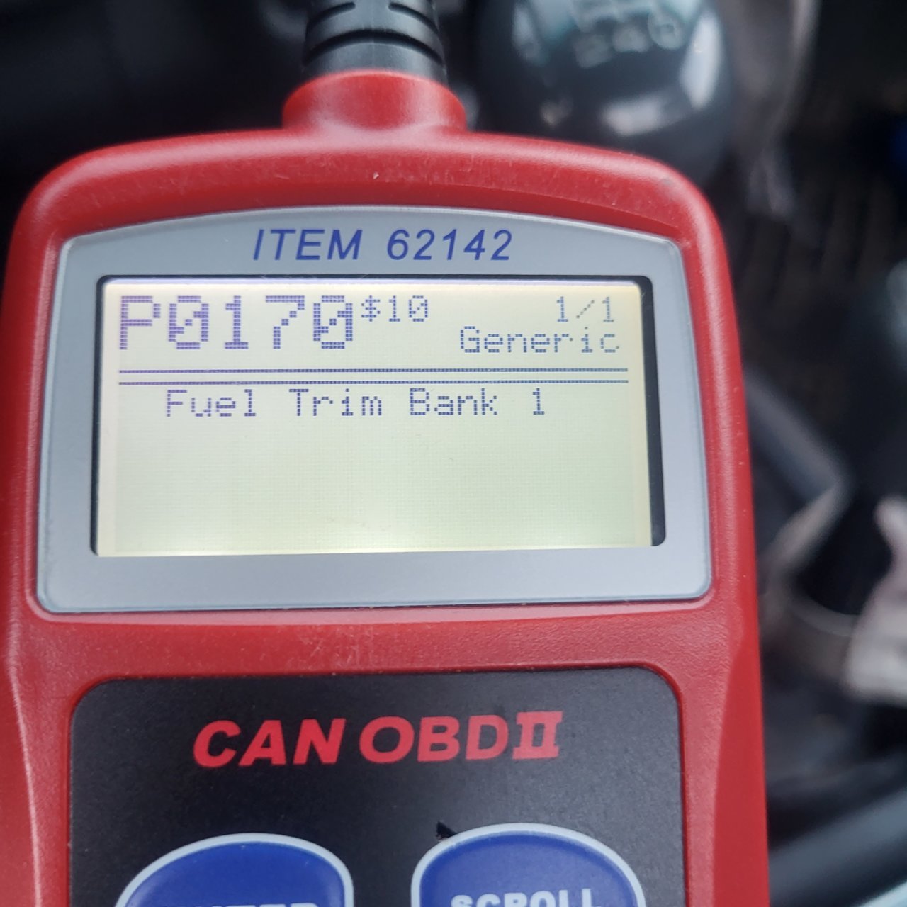

    Cleaned the M.A.F. this weekend, and ran the truck a short distance 5-8 miles. No issues.
    P0170 Code appeared this colder morning at start.
    Drove to work, 14miles at various speeds with no with no issues or symptoms. Gas is new and has not sat long.
    I have attached the freeze from data from my cheap scanner.
    I am thinking that its fuel related? Any ideas? Check fuel pressure? Change fuel filter?

    Replacing the fuel filter, especially if it's been in there for a while, is a no brainer to help narrow down the diagnosis.
