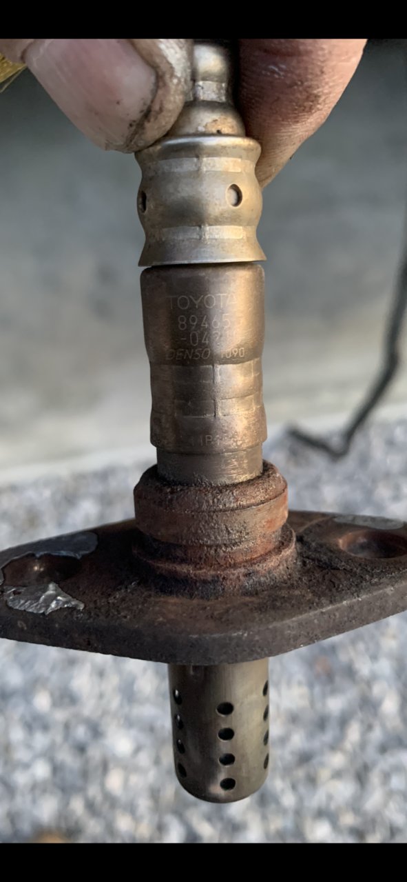

    Hi, I just recently ordered a replacement downstream o2 sensor for my 2001 tacoma (Denso 234-4189). I removed the current installed o2 sensor and it has a Toyota number of 89465-04210. I researched and can only pull it up as being offered used by TLS Recycling and shows to be for 2016 year model. Can anyone weigh in on this? Thanks in advance.......would this have caused a code issue?

    I understand sticking with denso, I was wondering why it would of had the Toyota sensor in it that has the listed part number.....it has been serviced by Toyota dealership for the past 15 1/2 years.

    You have two sensors. Go to Denso Site and put in the year vehicle. I would replace both.

    When I took out my original equipment O2 sensors I couldn’t make sense of the code on it either......Like others have said , and you did, just go with the Denso replacement.
    It looks like the sensor has been in since new, why would it only now throw a code after all these years ? Because it’s worn out .....plain and simple.

    Underpaid Toyota tech swapped a used sensor for new to put in his/her
    2000 Taco?
    Stealership didn't have the right part and could care less?
    Misteaks are made, especially on Monday and Friday.
    New members post bs to get to 50?

    I am not trying to post bs Black Dog Lila, I just purchased the truck and have all service records since 2005. The issue came up in like 2010, dealership quoted new cats as the issue. It had a code of p0402 , he never replaced the cats but the dealership charged him $283.00 for a new upstream a/f sensor plus labor. The dealership just installed upstream sensor on Feb 20, 2020. I purchased and light came on next day.......I ordered and replaced the downstream myself ........fingers crossed, so far .....so good. I just found it odd that the downstream Factory sensor came back to a 2016.......the nuts are sensor were so bad that it took a 11mm, and 10mm socket to remove a 12mm locking nut. Thanks for the feedback all, just a curious new taco owner.

    I know I will get slammed for this question, but oh well. When I pulled the old o2 sensor out it was wet, does this mean anything to anyone?

    Normal condensation in exhaust probably after sitting overnight.

    Wet with water ??
    Soaked in oil wet ?
    Wet can mean quite a lot

    It was wet with water, I replaced it with the new sensor..........so far, so good.
