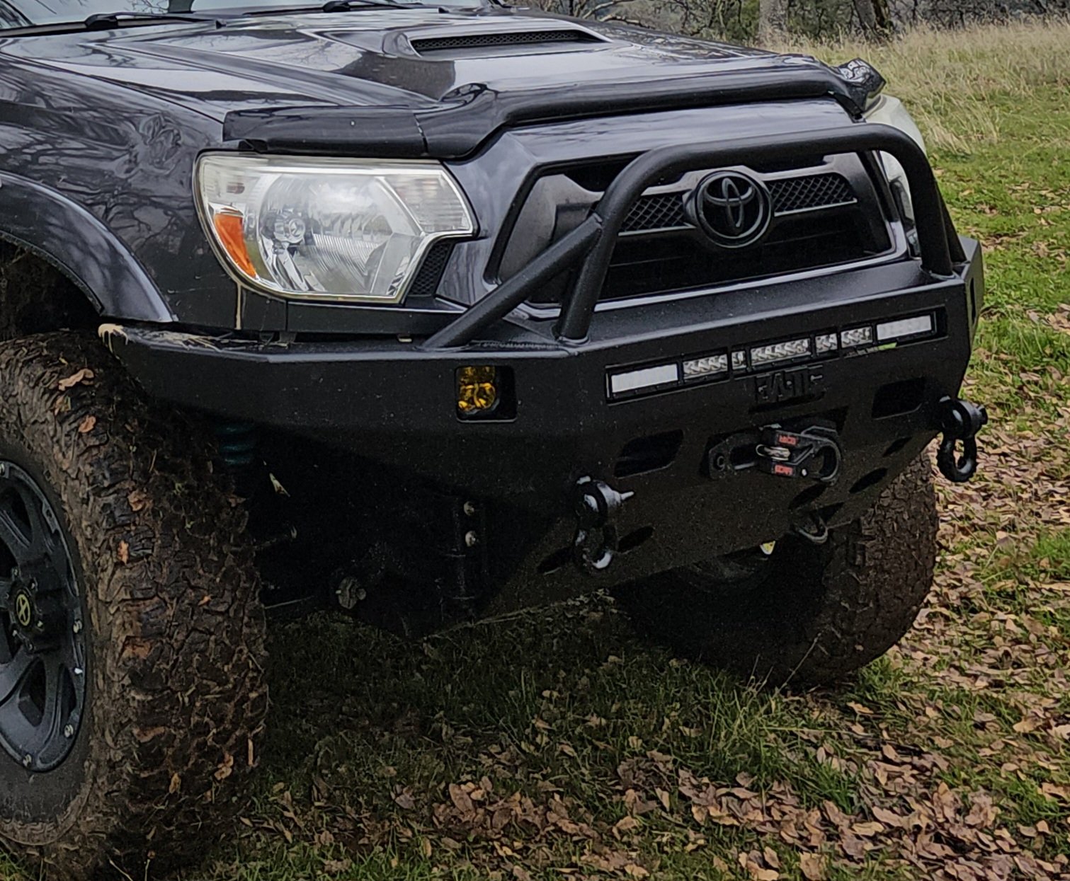

    I installed this by myself in my BAMF bumper. I have never installed a winch before but I have been doing all of my own mods except for my regear.
    I was able to mount the control box to the left with a small bracket that was provided. This made the install easy and no extra modifications were needed to fit.

    At first I had it clocked because I thought that would make it easier to reach the handle but then it actually interfered with the bumper so I had to undo it. I would recommend just leaving it as it is. You do need to move the control box off to the side in order for it to fit. There or two small bolts used to mount the control box and I found that they came up a little short to where I could barely get threads to turn so I used a couple of longer bolts. Also since installing the first time I have removed and reinstalled and I found that a couple metal baracket on the truck was rubbing on the control box so I did some slight modifications with an angle grinder.

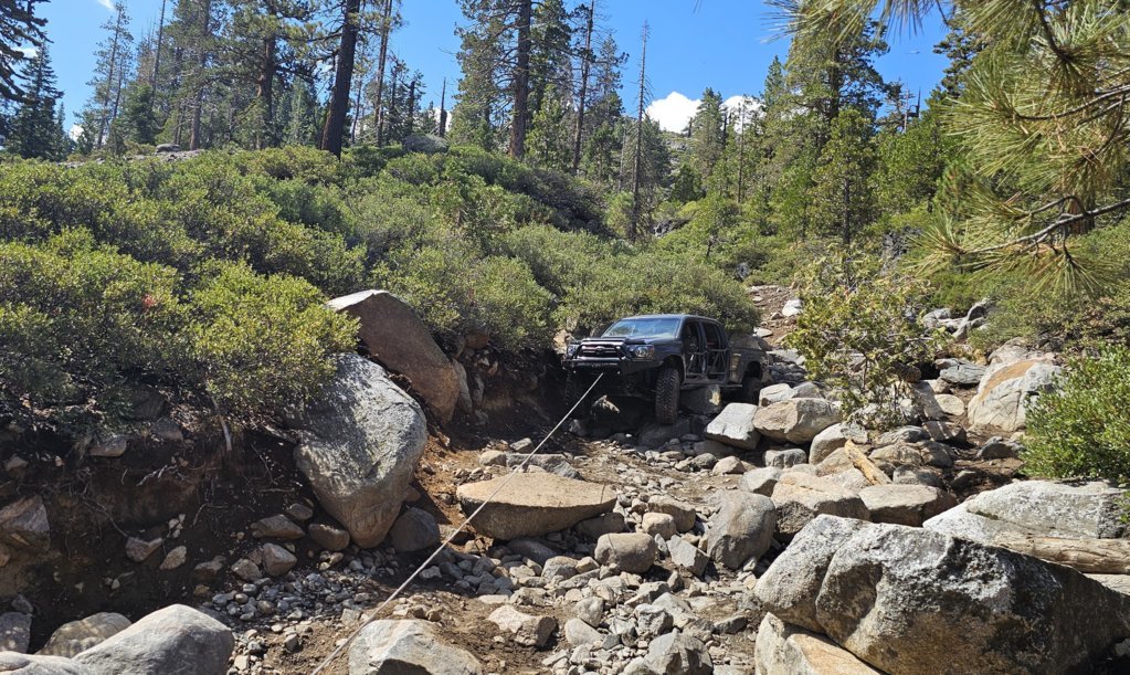

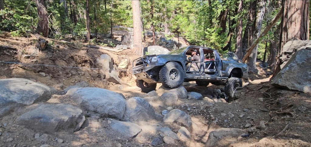

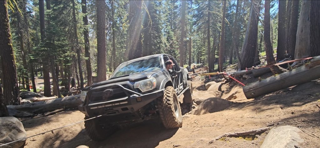

    Here's a time I was stuck on some rocks.
