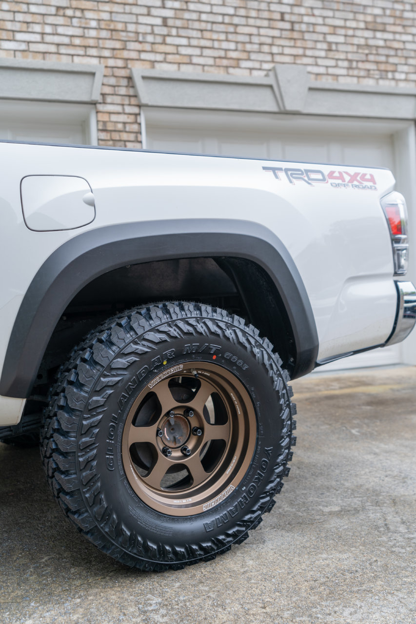

    Waiting on suspension parts to come in before I drive around due to some rubbing.
    Whoever says 285/70/17 at stock height won't rub must have been super lucky.
    It's only rubbing the very bottom corner of the front bumper.
    I'm tempted to just cut it away since the C4 bumpers will require completely chopping half the bumpers off anyways.
    We'll see tomorrow.

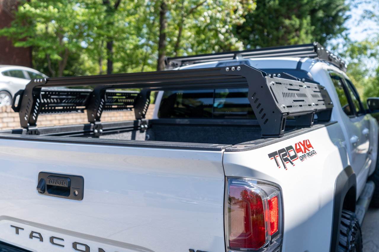

    Just installed UpTopOverland Alpha Roof Rack & Truss Bed Rack (Mid Height).
    Spoke to my father and he said he won't be doing anything crazy enough to need rock sliders.
    If he does later on, I'll go ahead and throw them on at that point.

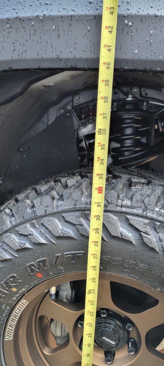

    Installed the Bilstein 5100 with OME2886 and also the SPC UCA.
    Driver's side UCA.... :frusty:
    That bolt was a pain in the ass to get out. Passenger side was 10x easier and much easier to reinstall since there's access through the engine bay.
    I'll post pics in the morning of the lift.

    Looks like ome 2886 on 5100's 0 setting is a 3" lift with just roof rack. We'll see how much the c4 bumper and winch drop it.

    Solid build! I'm considering doing the exact same racks, but I can't decide between the low-pro bed rack vs. the TRUSS system. Assuming that you picked the low bed rack to keep the RTT below cab height?
    Can you share a photo of how much space you have in the bed? I'm curious what the height is between the bottom of the rack and the bed.
